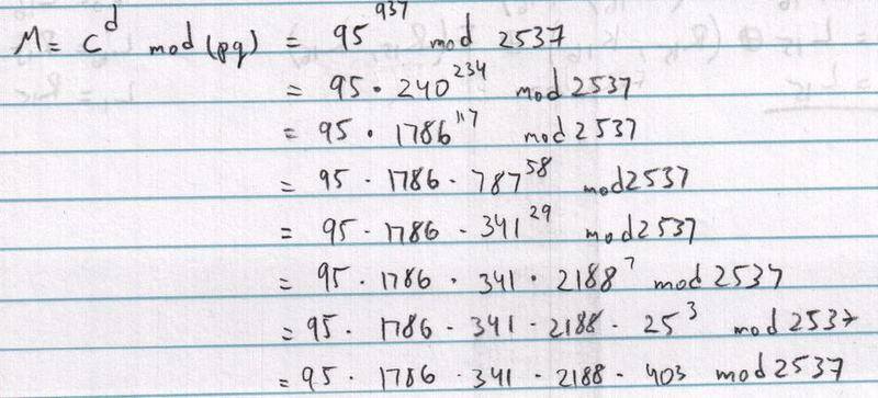

95937 mod 2537
None
Here's what my friend did:
How do I do this? and how did he do this?

what is the question exactly ?
how did my friend do it?
how did he break down the huge number?
basically
how do you compute 95937 mod 2537
I see, well the answer is 1520 but I found that by using MAGMA. Do not know yet how to do it manually.

Okay, I had this question in my exam and after being verified by other people, I think I got it correct.
95937 mod 2537 = 95512 mod 2537 x 95256 mod 2537 x 95128 mod 2537 x 9532 mod 2537 x 958 mod 2537 x 951 mod 2537
So now you do the mod from the power of 1 at .
951 mod 2537 = 95
952 mod 2537 = 1414
954 mod 2537 = (952)2 mod 2537 = 14142 mod 2537 = 240
958 mod 2537 = (954)2 mod 2537 = 2402 mod 2537 = 1786
9516 mod 2537 = (958)2 mod 2537 = 17862 mod 2537 = 787
9532 mod 2537 = (9516)2 mod 2537 = 7872 mod 2537 = 341
9564 mod 2537 = (9532)2 mod 2537 = 3412 mod 2537 = 2116
95128 mod 2537 = (9564)2 mod 2537 = 21162 mod 2537 = 2188
95256 mod 2537 = (95128)2 mod 2537 = 21882 mod 2537 = 25
95512 mod 2537 = (95256)2 mod 2537 = 252 mod 2537 = 625
From the first equation:
95937 mod 2537 = (625 x 25 x 2188 x 341 x 1786 x 95) mod 2537
95937 mod 2537 = (625 x 25) mod 2537 x (2188 x 341) mod 2537 x (1786 x 95) mod 2537
95937 mod 2537 = (403 x 230 x 2228) mod 2537 = 1520
