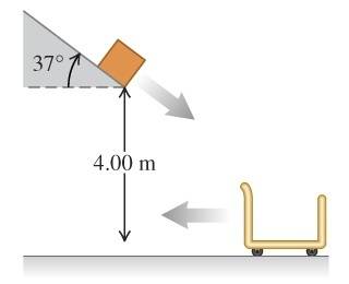

In a shipping company distribution center, an open cart of mass 51.0kg is rolling to the left at a speed of 5.50m/s (see the figure). You can ignore friction between the cart and the floor. A 10.0kg package slides down a chute that is inclined at 37degrees from the horizontal and leaves the end of the chute with a speed of 2.60m/s . The package lands in the cart and they roll off together.
(a) If the lower end of the chute is a vertical distance of 4.00 above the bottom of the cart, what is the speed of the package just before it lands in the cart?
ans: 9.23m/s
(b) What is the final speed of the cart?
ans: 4.26m/s
The attempt at a solution
I think this is a prefectly inelastic collision when the package falls into the cart.
For first part, is it use v^2 = u^2 + 2as?
where u = 2.6m/s and a = -9.8 and s = -4?
i get the answer 9.23, but i not sure if this is correct cos i din take into acct that the package falls from a slope at an angle. does the angle matter?
For 2nd part, i duno how to do. I tried using conservation of momentum but i can't get the answer.
my eqn is: Mp * Vpi + McVci = (Mp + Mc)Vf
and i get Vf as 5.02m/s
Pls help me.. Thanks!
Your thinking is probably a bit off, but lucky for you you get the right answer anyway. To do it right, using acceleration, you'd need the component of the initial velocity in the vertical direction. But then you'd be adding back the horizontal component later to find the total velocity.
Even better would be to use conservation of energy. Then it would be clear that the angle doesn't matter (for this part).
Hint: During the collision of package and cart, momentum (a vector) is only conserved in one direction. (Which direction?)
oh.. we need to add back the horizontal part! it din occur to me that we need to add that back. hmm. how do we know if we can use energy to solve a qns?
during collision, momentum is conserved in x direction?
Yes.
Just try it and see! In this case, mechanical energy is conserved (in part A) so it can be used.
Right! Now you need the speed of the package in that direction to analyze the collision.
so its Mp*Vpxi + Mc*Vcxi = (Mc + Mp)*Vxf right?
i get 4.94m/s, but answer is 4.26m/s..
Right.
What were your values for Vpxi & Vcxi?
my Vpxi is 2.6cos 37
Vcxi is 5.5
correct?
Vcxi is 5.5
Correct. Different signs, of course.
Recheck your arithmetic: 2.6 cos 37 = ?
we must include the signs?? means vcxi is -5.5??
2.6cos 37 is 2.0764
means even for momentum qns, we need to consider the signs for velocity?
can i ask sth? like when we calculating potential energy, the gravt acceleration, do we need to consider the -ve sign if we take upward as positive?
2.6cos 37 is 2.0764
Absolutely. Signs matter.
And that's the difference in your answer that you are looking for.
