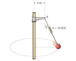

The spring has a 2 lb/ft, and the bob has a tangental velocity of 6 ft/s, and a weight of 10 lb.
I need to find the angle theta.
I decided to try getting the centripetal acceleration first:
[tex]a_{c}=\frac{v^{2}}{r}=\frac{36}{r}[/tex]
which led me nowhere. I tried a mess of things.
The best I could come up with was a triangle with three unknowns, the hypotenuse of which was the spring.
The solution manual is quite confusing.
Let l be the length of the spring
It sets up the force of the spring as this:
[tex]F_{spring}=ks=20(l-2) lb[/tex]
I don't get where they got l-2 from.
Then it goes on to this:
[tex]a_{c}=\frac{v^{2}}{r}=\frac{36}{0.5+lsin(\theta)}[/tex]
The rest of it is simple enough to understand, it's just messing with the net forces. The setup of this is what I don't get. How did they arrive at that formula for the spring force, and then stick it into r like that?
Hi Lancelot59! :smile:
2 feet must be the unstretched length of the spring (so l - 2 is the extension) :wink:
I see. So that's the spring's displacement.
How did they derive that expression for r then? I understand where the lsin(theta) term comes from, but why are they adding 0.5? Would it not be 6?
erm :redface:
feet! :biggrin:
tiny-tim said:
erm :redface:
feet! :biggrin:
Oh! I see. I don't usually work with the imperial system. Thanks!
