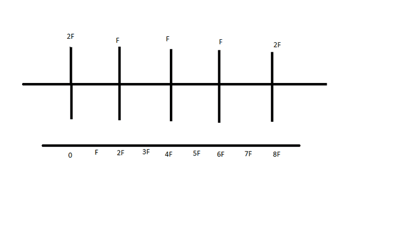

*The diagram of the telescope is attached*
Question states
A telescope is constructed from five thin lenses of Diameter D and focal lengths 2F, F, F,F,2F
located at x = 0,2F,4F,6F,8F
Trace the path of a ray entering the system parallel to the optical axis
This is undergraduate lab in chemistry but I haven't done physics before, I understand the middle line is the optical axis, but not much more. I've tried to do some reading but nothing seems to relate back to this question as it has little information about the type of lense/telescope and I seem to just be confusing myself completely
Any help really appreciated, quite confused!

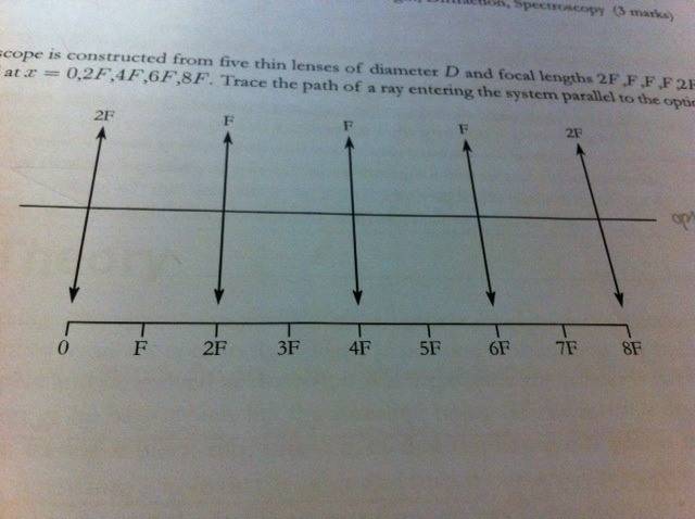

the only difference between the question and my diagram is the diagram has arrows pointing up and down on the lenses, does that indicate convex too?
chemphys1 said:
Yes all the focal lengths are positive,
I don't think so. As you can see in the Google Images, arrows are sometimes used to show when an image is inverted or not. Can you post a scan of the actual problem image?
attached
Oh, double arrows. Yes, that might also imply convex/converging lenses.

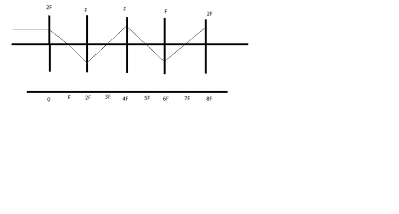

So can you draw the first ray, coming in from the left about half-way up the first lens? Where does it cross the centeral axis?
Like that? crossing at focal point F after the lens?

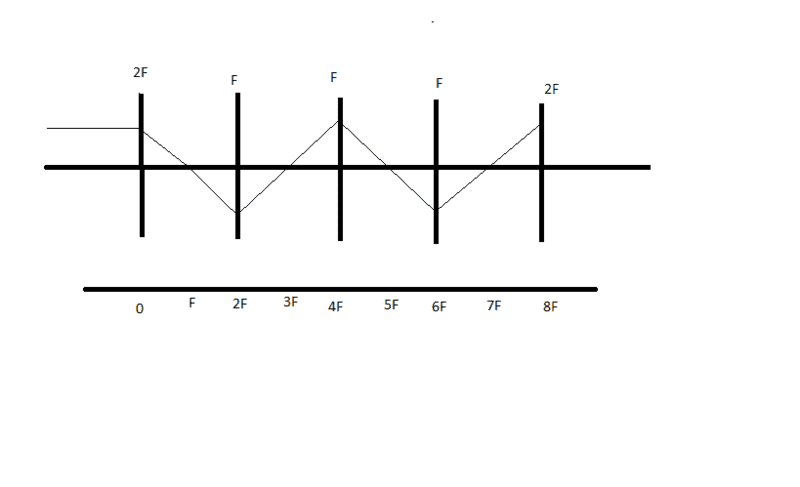

is the whole pathway of the ray this? keeps going back through the next focal point?

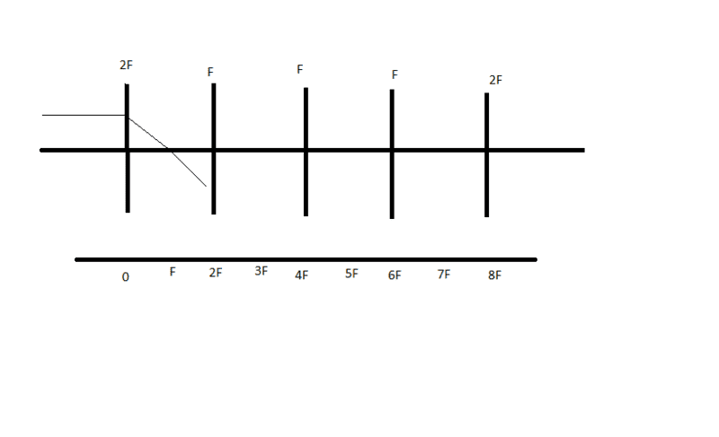

The first lens has a focul length of 2F, not F.
How does that affect the ray, does it not converge to the focal point at 3f?
would it hit the optical axis at 2F on the x axis, through the centre of the 2nd mirror?
this?

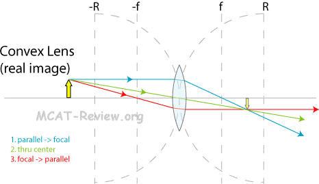

This may help you. Here you can see the ray paths.
http://mcat-review.org/light-geometrical-optics.php
Sorry thank you for all the help but I'm really not understanding
The question says trace a ray, will I have 1 line like I did in my diagram or 3 lines like these images?
I literally knew nothing on optics before this question and my google searches were getting me more confused, including all these diagrams with lines going everywhere, multiple focal points etc.

That is your problem statement:
So you have to trace only the parallel ray, but you will need all 3 cases to draw it to the end.
Yes. But in the figure you posted, it did not do that.
chemphys1 said:
Is my attempted diagrams completely wrong?
You just need 1 ray, as you have been doing. You started correctly with the parallel-to-the-axis ray, but things went wrong after the 1st lens -- hopefully what I posted above helps with that.
