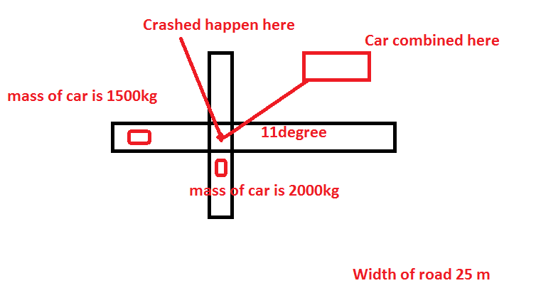

The problem is that there are too cars and they crash and we have to gigure out which one was the one that caused the crash?
Also it is a four way stop
here is a pic that would help
Find Velocity
I don't know where to start

The only thing I can suggest is look at the formula for the conservation of momentum.
[itex]P_{1}+P_{2}=P_{3}+P_{4}[/itex]
P=mv, so let's fill in what we know.
[itex]1500v_{1}+2000v_{2}=P_{3}+P_{4}[/itex]
You said the cars combined, so P3=P4. We'll call this Pt
[itex]1500v_{1}+2000v_{2}=3500v_{t}[/itex]
That's the farthest I can take you, since we don't know any of the velocities. Could you post the actual wording of the question, and see if there's any information you left out?

I just realized that the angle is 30 degrees and the distance they traveled after crash was 11 meters
I made a mistake in the pic
Well, the only thing I can think of is this:
Since both cars arrive at the same point at the same moment, the time it took them to get there from their different points must have been the same. Therefore,
[itex]\frac{1500d_{1}+2000d_{2}}{t_{o}}=\frac{3500d_{f}}{t_{f}}[/itex]
As I was typing this, I saw your edit.
That makes a bit of a difference. If you know the distance they travelled, you can fill that in the formula.
[itex]\frac{1500d_{1}+2000d_{2}}{t_{o}}=\frac{38500}{t_{f}}[/itex]
Unfortunately, I'm not sure where to go from there.

I've had an idea, though I have no clue if it's right.
Theoretically, vf=v1+v2
Therefore, if you disregard time, df=d1+d2 should also be correct, though I'm not totally sure.
If it is, then 11*cos(30)= 9.526 m, and 11*sin(30)=5.5 m
[itex]\frac{25289.419}{t_{o}}=\frac{38500}{t_{f}}[/itex]
[itex]25289.419t_{f}=38500t_{o}[/itex]
t[itex]_{f}\approx1.522t_{o}[/itex]
Don't take my word for that, though; I'm not 100% sure it's right.
It looks pretty accurate but I am not even sure we need time for this problem, but again thanks for your help
Since the friction after the crash is unknown, the distance traveled tell us nothing. With information provided, you can determine the ratio of the speeds of the two vehicles, and that's all. E.g., in one extreme, they were both traveling quite slowly but the road surface is an ice rink.
The diagram shows both cars in the middle of the road and the crash in the centre of the junction. OTOH, it gives the width of the road. If we assume each was driving on the right, the 1500kg car had further to go from the stop line to the impact point. If you make some reasonable assumption about the lengths of the vehicles, the ratio of the speeds might be enough to come to a conclusion.

Can you calculate the speed ratio? Consider conservation of momentum in the two approach directions and use the known angle after the crash.
