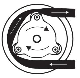

Hello,
I designed a tiny peristaltic pump which works really fine. I am using a very thin tubing of 0.5mm diameter, which makes me struggle with capillary action, unfortunately.
When my pump is not working, sometimes liquid still flows into the tubing because of capillary action. Do you have an idea to prevent it? I am trying to design a "pusher" that "sandwitches" the tubing at the exit of the pump, that pushes enough on the tubing to avoid capillary action but still allows liquid to flow when my pump is working. So far I couldn't find the right pressure to make it possible. I was wondering whether there existed some kind of valve that prevents capillary action?

Welcome to PF. :smile:
Did you use the traditional layout of a Peristaltic Pump, where there is always at least one roller pinching off the tubing even if the pump is not spinning?
https://control.com/technical-articles/understanding-peristaltic-pumps/

As mentioned above, at least one roller should be fully blocking any back-flow by reducing the cross-section area to zero.
Could you explain that capillary action a little further?
If that is the case, and you still experience some of it, no check valve will solve the problem, unless is spring loaded or relative high output pressure; therefore, introducing a higher load on the pump during normal operation.

Yup I am using a typical layout for my pump, I have 6 roller bearings and 3 of them constantly pinch the tube shut while at rest.
The liquid doesn't go through the pump "at first", but after some time (probably because my tubing gets wet and creates some air bubbles) capillary action makes the liquid flow, in some pumps only, it's quite random...
My pumps are tiny, so reducing their diameter again (to push very hard on the tubing) might prevent the pump from working properly... and also damage the tubing rather quickly.
I also read that too much pressure on the tubing might actually make the capillary action worse, by increasing tension. Any idea?
