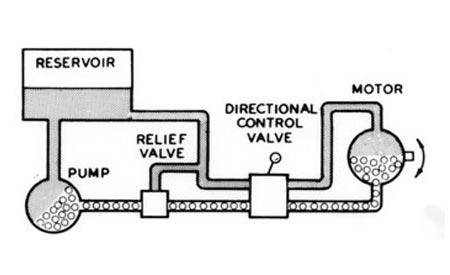

Typical hydraulic system diagram:
https://crossmfg.com/resources/technical-and-terminology/basic-hydraulic-theory
