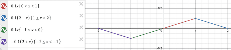

This is what I thought: F should be periodic in interval (-2, 2). The initial graph of ##f(x)## has the shape of triangle and the reflection about origin will produce inverted triangle for interval (-2, 0). This is the graph with the corresponding equation for each interval:
Is that not the odd periodic extension of ##f(x)##?
Thanks

A periodic function repeats once every period forever. Your function is only defined on (-2,2).

No. You need to somehow specify that your function has a period of 4.
