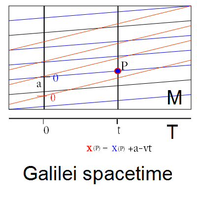

Ok. Here it goes. There are many ways in which the Galilei spacetime can be introduced, but the simplest one is via defining it in terms of its group of transformations, which is the inhomogeneous Galilei group. It consists of translations in space, translations in time, rotations in space and Galilei boosts. Altogether 3+1+3+3=10 parameters. Since rotations are not important for understanding its structure, let's restrict ourselves to 1 time and 1 space dimension. Then it is easy to draw a picture. In this case a element of the Galilei group is a linear transformation in [tex]\mathbf{R}^2[/tex] given by:
[tex]t'=t+t_0[/tex]
[tex]x'=x+a-vt[/tex]
Here [tex]a[/tex] is the translation in space parameter, [tex]t_0[/tex] - translation in space, and [tex]v[/tex] is the boost parameter.
Then the Galilei spacetime M is defined as a set (say, a 4-dimensional manifold) endowed with a family of global coordinate systems [tex](x,t)[/tex] in such a way that the transitions between any two coordinate system from this family are given by Galilei transformations. So, we have a 10-parameter family of distinguished coordinate systems - we may associate with them terms such as "inertial frames" or "inertial observers". In our 2-dimensional case this is a 3-parameter family. I will refer to them simply as "frames"
Once this is done the next thing to do is to study its "geometry" i.e. according to Felix Klein, yo study the invariants of the group of transformations.
We notice that the form [tex]dt[/tex] is invariant.Even more, if two points [tex]P_1,P_2[/tex] have the same coordinate in one frame, they have the same coordinate in any other frame (of our distinguished family). We call the set of such points "space at a given time). We also notice that if two points [tex]P_1,P_2[/tex] have the same time coordinates, then the distance [tex]d(P_1,P_2)=(x(P_1)-x(P_2))^2[/tex] is an invariant. Therefore each space at a given time is an affine Euclidean space - with its Euclidean flat metric.
We notice that our transformations are linear. Therefore we can give M the structure of the affine space. Or, if you prefer, there is a distinguished globally flat affine connection on M characterized by the fact that its connection coefficients are globally zero in all frames. Both time form and space metric have covariant derivative zero with respect to this connection.
Now, let us have a look at this picture:
Blue lines are trajectories of points with a constant x of one frame, red lines - for another frame. We chose a point P at time t. It has red coordinates in one frame, blue coordinates in another frame. Here we neglect time translation - which is easy to take into account, but it will not add anything of importance. Verical lines are spaces at a fixed time. These are distinguished geometrically - defined in an invariant way. But there are no distinguished horizontal lines.
Each frame defines an isomorphism between M and [tex]\mathbf{R}\times\mathbf{R}[/tex], different frames define different isomorphisms. M can be represented as a product, but in many (10-parameter family for our 3-dimensional space and 1-dimensional time) ways, but they are all on equal footing. This is in contrast to Newton's time. For Newton (also Kant) there was also an "absolute space" - something like an "aether". Perhaps in reality there is such a thing, but here we have spacetime as an arena for studying, say, one or several particles in an otherwise empty space". Later we can study Galilean cosmology and find solutions of the corresponding field equations that break the full Galilei symmetry, but that is another subject.
