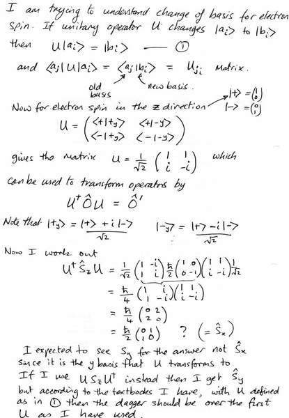

I am struggling to understand spin transformations and have used Sakurai's method of
|new basis> = U |old basis> to change basis vectors and hence should have
Sz' = Udagger Sz U
to transform the operator. I thought this should give Sz' = Sy in the workings (see attachment below) but it gives Sx instead. If I use
Sz' = U Sz Udagger then I do get Sz'=Sy but according to the texts I have, the first arrangement is the correct form. So I'm really confused. Can anyone see what I'm doing wrong here.
2. Homework Equations
I would be really grateful for any help with this. Thank you
  • Handwritten notes on change of basis for electron spin: unitary operator U maps |a_i> to |b_i>, matrix elements, spin z basis vectors, U matrix, and a worked calculation of U-dagger Sz U giving a Sx-like matrix.
. 3. The Attempt at a Solution (The attachments are not letting me paste the math here so I have posted the link to my calculation instead). My Calculation: https://ibb.co/n6nC9x
