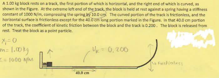

^ Please ignore my writing. The correct variables:
- Xi (initial position) = 10cm (.01m)
- Mass = 1kg
- Uk (kinetic coefficient) = 0.200
- K (Stiffness constant) = 1000 N/m
Question: What is the value of the work done by gravity?
Force of gravity= Mass x acceleration
Work by gravity = mgh
Force by gravity = 1kg x 9.8m/s2 = 9.8N
Work by gravity = 1kg x 9.8m/s2 x h
I'm having problem finding the last variable, h, the height.
Please help. My final is on wednesday. I have other problems too but I'll start off with this one. Thanks for any input!

Figure out how much energy is lost due to friction on the horizontal part, subtract that from the total energy it started with (which can be used by looking at the elastic potential energy). Once you have the total energy it has when it starts up the ramp it should be simple to find the height.
However, that being said you don't need to. If you can find the energy at the base of the ramp, think about what it's energy will be at the top.

He means the energy at the base of the curved part. Use the spring's potential energy along with the energy lost via friction and you'll get this value.
Okay, let me try this:
Spring's potential energy: 1/2 x (1000) (.01)2 = 5J (her answer sheet has - 5J, why is that?)
Work done by friction: -.784J
-5J +.784J = - 4.216J (Yay! this is the answer!)
Could be several reasons, maybe she defined directions different, ect. However if you use the numbers you got it should work out to the same answer.

Yeah, but look what you did.
You found work to be -.784J and energy to be 5J, but you changed it to -5J and +.784, all you did was flip the minus. Don't forget in physics all a negative sign means is direction, as long as you are consistent you are fine. My guess is her negative came from making the .01 in the spring equation negative (because the spring is compressed to the left).

Since energy is conserved, the 5 J that was stored in the spring was converted entirely into kinetic energy upon release. Some of that kinetic energy was lost due to friction, and the rest of it was converted into gravitational potential energy as the block ascended the curve.
