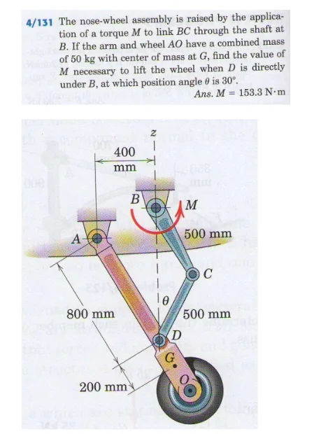

Hi I'm stuck at how to draw the free body diagram for thise nose wheel question
Moment equal 0
see attached
Textbook problem 4/131 with the statement that a torque M lifts a nose-wheel assembly through link BC, with a diagram of the linkage: points A, B, C, D, O and G, lengths 400 mm, 500 mm, 800 mm and 200 mm, and angle theta at D.

I think it is safe to assume that links BC and CD are massless because no masses are given for them. Assume that the torque at M gives rise to a force ##F_D## at D that is just right to prevent the combined (arm + wheel) assembly AO from rotating either clockwise or counterclockwise.
Consider the external force and moment acting on the whole mechanism first.
One is the represented M, which is necessary to raise the combined mass of 50 kg, which can be represented as a vertical force applied at point G.
Note that the value of that vertical force will be constant, while the value of the necessary moment M will change as the wheel is being raised, reason for which the problem asks for the value of moment M at that specific position of the mechanism's stroke.
