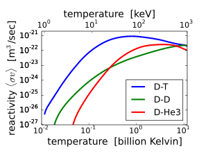

I am inquiring as to what the theorem function is for the mean product of cross section and velocity for stellar fusion reactions? [tex]\langle \sigma v \rangle[/tex]
Log-log plot of reactivity <sigma v> in m^3/sec against temperature in billion Kelvin (bottom axis) and keV (top axis), with three curves: D-T (blue), D-D (green), and D-He3 (red).
Mean product of nuclear fusion cross section and velocity. [tex]\langle \sigma v \rangle[/tex]

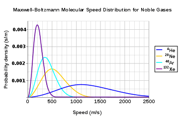

Graph titled Maxwell-Boltzmann Molecular Speed Distribution for Noble Gases, plotting probability density against speed in m/s for 4He, 20Ne, 40Ar and 132Xe, with the lighter gases peaking at higher speeds.
Maxwell–Boltzmann probability density function:
[tex]f(v) = \sqrt{\frac{2}{\pi}\left(\frac{m}{kT}\right)^3}\, v^2 \exp \left(- \frac{mv^2}{2kT}\right)[/tex]
The mean speed is the mathematical average of the speed distribution:
[tex]\langle v \rangle = \int_0^{\infty} v \, f(v) \, dv = \sqrt{\frac{8kT}{\pi m}}[/tex]
