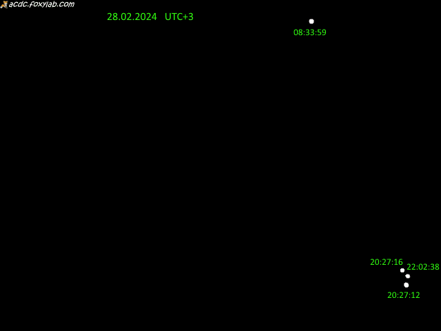

Hello! This is my first post on this forum. I am writing because I would be very interested to know the opinion of the forum participants on this issue. Almost ten years ago, I wrote a program Cosmic Ray Finder to record particle traces on a webcam (analogue of the project DECO) (the webcam is placed in an opaque container, the frame from the camera is read in a loop and it is determined whether there is a noticeable excess above the average brightness level - if so, the frame is saved).

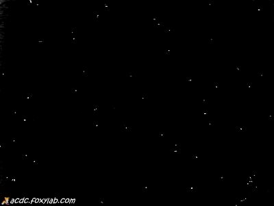

In most cases, events are small dots, dashes, and fragments of curves:
But once on average for every hundred or two events, points of sharply increased size occur. Most often, several such events occur in one day, and then again there is a long break. And the strangest thing is that neighboring large dots (which can be separated in time by hours) can fall next to each other, even overlap (although the sizes of the matrix are several millimeters!).
Recent examples of "big spots":
two particles, separated in time by 136 minutes, actually hit the same point in the matrix:
group of three particles:
How can this be?!!!! Do the particles fly in a very narrow beam? Where?

Often neighboring events fall into the same area of the camera, sometimes even overlapping. But the size of the camera matrix is several millimeters.
Imagine the probability of such a coincidence. And they happen more than once.

I have several questions. First is how sure are you that these events are actually cosmic rays? The DECO app claims to do some analysis of candidate events before deciding they are. Do you do more than naive thresholding? Have you tested it at different altitudes, for example? Or investigated what is needed to stop muons and tried shielding it?
Second, coincidences are more common than people think. Divide your detector up into a 20×20 grid - that's 400 areas. If you have two events drawn from a uniform distribution the chances are ##1-\frac{399}{400}## that they're in the same area. Three events and the chances are ##1-\frac{399\times 398}{400\times 400}## that at least two are in the same area. You actually only need 24 events before you've got better than a 50/50 chance that two occur in the same region. Google "birthday problem" for a textbook example.
Finally, what happens to your CCD if a pixel is saturated? Some charge may flow into adjacent pixels. Some digital cameras also don't actually feed you the raw information and you may be seeing some processing artefacts.

Detector artefact in the form of spots of approximately the same size, which are recorded say once a week, not one after another, but after an hour, and in the same area of matrix (the next group of events is in a different area)? What mechanism could provide such an artifact?
Almost every group of such events has hits in the same area.

Detector noise is the obvious one. As I noted, DECO says it uses thresholding to identify candidate images, but then "performs more thorough follow-up processing to determine if the candidate should be considered an event". You only seem to be doing the first part, so you could just be seeing noise. Have you tried at different altitudes, or shielded?

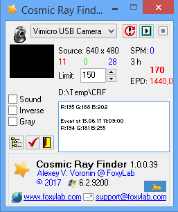

Some test of my detector - old airplane tachometer with radium phosphor:
1440 events per day !!! (usually - 10...20)
Differences between regular events and "big spots":
First, you haven't convinced me you are looking at cosmic rays at all. No matter what the app title says.
The cosmic ray rate is one through your head every second: 1 kHz/m2. Your sensor, therefore, at maybe half a square centimeter would get one every 20 seconds. If there are 5 million pixels, each pizel would get a hit every 100 million seconds. Every three years.
No detector is that quiet that you get one noise pulse every three years. Conclusion - your "cosmic rays" have a lot of noise in them. Maybe predominantly noise.
The second point is that seeing two events in the exact same pixel two hours apart is evidence against cosmic rays. Your phone is sitting on a rotating earth. It moved 2000 miles between hits. How can two hits from the same source end up in the same pixel if the phone has moved 2000 miles?

As @Vanadium 50 pointed out, the spots are hours apart and the Earth turns - those spots are hundreds of kilometres apart at least. If those coincidences are above background (and you don't appear to have done any statistical analysis, just shown us a couple of images) then this points to a local issue, most probably in the detector. That's why we keep coming back to noise.

All detectors have defects. What you sae describing are probably bright defects in the detector that the App sometimes decides is a cosmic ray. This is why they happen in the same pixel or in the same region.
