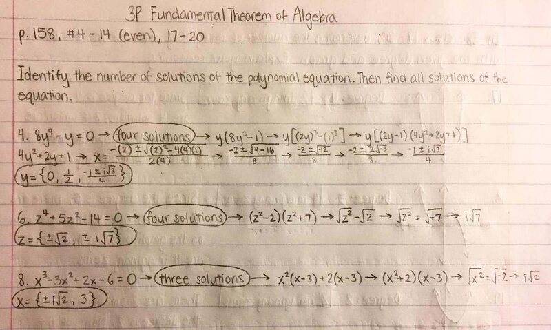

I have a very urgent question, this is the problem. I have no idea how to solve this. I don't even know where to start. This is urgent, please at least tell me what is the name of this kind of problem so I can look it up.
Specifically, # 4, 6 and 8.
I can guess #4 by dividing both sides by y to get 8y^3-1=0 or y^3 = 1/8 or y = 1/2.
I have no idea how to solve 6 and 8.
Thanks
As the problem says these questions involve "solving polynomial equations".
That's right. And that is not "guessing", that is how it should be done.
For 6, set ##x=z^2## and factor ##x^2+5x-14##. That gives the values of ##x=z^2## and you can get the values of ##z## from it.

I looked online, for #6, I substitute u = z^2 to get u^2+5u-14=0 and solve u.
I still have no idea how to solve #8.

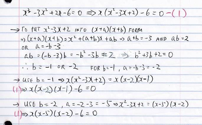

For #8, I simplified it, but still don't know how to solve it other than guessing
Any suggestion?
thanks

I guess my grand daughter still the best. She figured out. This is her work she email me.
She doesn't have to guess.
That's why she was the student of the year two years ago. I am so proud.

For #8, the rational root test is a really good place to start. You just have to check if 1,2,3 and 6 are roots (also their negatives), find that 3 works, then you can factor (x-3) out and solve the remaining quadratic.
If there are no rational roots then this doesn't work, but if there are no rational roots of a cubic with integer coefficients you probably can't solve it anyway and it won't be on the homework :)

Dividing by the variable is not the right approach, because you will lose solutions. Since the original equation was of fourth degree, there are four solutions, one of which is y = 0. Besides this solution, and the solution you show, y = 1/2, there are two more solutions, both complex.

That's one approach, but the approach used by the granddaughter is more clever. I first tried guessing, using synthetic division to test my guesses, but then noticed that factoring by grouping would have been much quicker.
##x^3 - 3x^2 + 2x - 6 = 0##
##\Rightarrow x^2(x - 3) + 2(x - 3) = 0##
##\Rightarrow (x^2 + 2)(x - 3) = 0##
From the last equation it can be seen that x = 3 is a solution, and there are two more (imaginary) solutions.

For (8) spot that ##(x-3)## is an 'obvious' factor of the polynomial.
Which has been done.
