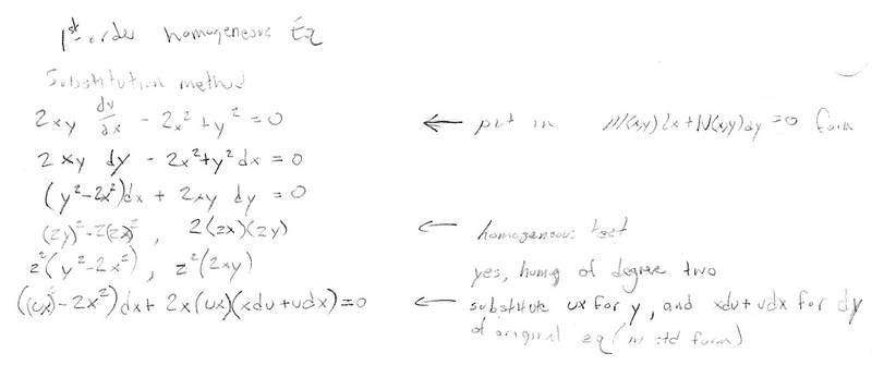

I put it in std form, did the homogeneous test. it passed with degree 2. I substituted y=ux and dy=udx+xdu and now I'm stuck. it needs to be simplified somehow but I don't know if ux is one var or if it's u*x. Same goes for udx and xdu. Is it really u*dx+x*du? even assuming that is correct, it doesn't get any simpler. What does the next step look like for this problem?
That is good so far, the substitution has transformed the equation into separable form, divide to complete separation.
$$\frac{\mathrm{f}(u)\mathrm{g}(x) \mathrm{dx}+\mathrm{p}(u) \mathrm{q}(x)\mathrm{du}}{\mathrm{f}(u) \mathrm{q}(x)}=\frac{\mathrm{g}(x)}{\mathrm{q}(x)}\mathrm{dx}+\frac{\mathrm{p}(u) }{\mathrm{f}(u)}\mathrm{du}$$$$\frac{((ux)^2-2x^2)\mathrm{dx}+2x(ux)(x \mathrm{du}+u\mathrm{dx})}{x^3(3u^2-2)}=\frac{\mathrm{dx}}{x}+\frac{2u\mathrm{du}}{3u^2-2}=0$$
Where did you get the denominator x3(3u2-2) from?
What does f(u), g(x), p(u), and q(x) each equal?
In this example
[tex]\mathrm{f}(u)=3u^2-2 \\<br /> \mathrm{g}(x)=x^2 \\<br /> \mathrm{p}(u)=2u \\<br /> \mathrm{q}(x)=x^3[/tex]
This is just separation of variables
$$((ux)^2-2x^2)\mathrm{dx}+2x(ux)(x \mathrm{du}+u\mathrm{dx})=(3u^2-2)(x^2)\mathrm{dx}+(2u)(x^3)\mathrm{du}$$
So we divide by the the factors that do not match their differentials.

That is just the separation of variables equation.
Write the equation in the form of each differential multiplied by a function of each variable, divide by each non-matching function to give each differential multiplied by a matching function.
[tex]((ux)^2-2x^2) \, \mathrm{dx}+2x(ux)(x \, \mathrm{du}+u \, \mathrm{dx})=<br /> x^2(u^2 -2) \, \mathrm{dx}+2x^2 u(x \, \mathrm{du}+u \, \mathrm{dx})\\<br /> =x^2(u^2 -2) \, \mathrm{dx}+(2x^2 u)x \, \mathrm{du}+(2x^2 u)u \,\mathrm{dx}\\<br /> =x^2(u^2 -2+2u^2) \, \mathrm{dx}+2x^3 u \, \mathrm{du} \\<br /> =(3u^2-2)(x^2) \, \mathrm{dx}+(2u)(x^3) \, \mathrm{du}[/tex]
thanks. I got it now.
