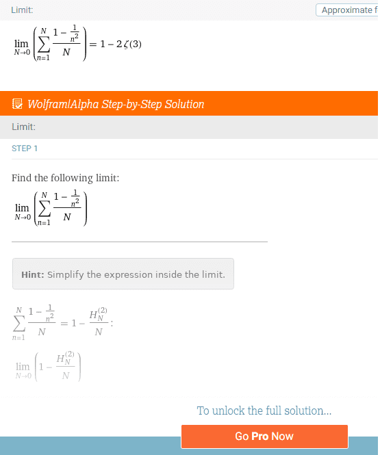

Yes, I agree. Perhaps someone could have a look at wolfram alpha's step by step proof for this answer. I must admit it is beyond me.
Are you referring to equation 23 on the page on harmonic numbers? Where is your sum from ## 1..\infty ##?
I did see that, and I assume it's used somehow in the result I posted. I used wolfram's solver directly. I don't have "pro" so I can't see the steps.
I guess wolframalpha is just making a mistake. Perhaps it solves an intermediate step and then applies a limit that violates a previous step?
but $$\lim_{N→0} [1-\frac{H_N^{(2)}}{N}]=1-2\zeta(3)≈-1.40411$$
is very believable. ## H_N^{(2)} ## goes to zero as ##N## does. Just at a different rate.
No, this is nonsense. Given the two possibilities
  1. Wolfram Alpha is making a mistake
  2. You are making a mistake in your input to Wolfram Alpha (or your interpretation of the result)
I know which I find more believable. Why don't you post the link to the result?
https://www.wolframalpha.com/input/?i=lim+N->0+{∑(1-1/n^2)/N+,+n=1,N}
Are we seeing the error right after the first step?
btw, WA gives real solutions for all ##N##, except the negative integers, which seem to all be negative infinity.

The confusion is now clear.
For positive integer values of ## n ##, we define the generalised harmonic number $$ H_n^{(r)} = \sum_{k=1}^n \frac1{k^r} \tag 1 $$
(note that it helps to avoid confusion by avoiding using ## n ## for the index of summation and ## N ## for the limit).
We can also find a continuous function ## H(x, r) ## which interpolates the values of ## H_n^{(r)} ## at positive integer ## n ##; this function is described in the references to the linked Wolfram Alpha article. It can be shown that $$ \lim_{x \to 0} \frac{H(x, 2)}{x} = 2\zeta(3) \tag 2 $$ and this is indeed an interesting result.
However what you can't do is put these two together: equation (1) tells us about what happens at positive integer values, equation (2) tells us about what happens near 0.

Garbage In, Garbage Out.
Thank you for your help clearing this up.
