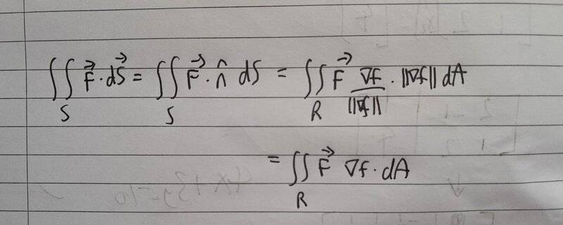

Alright so my confusion lies in the following step: Consider the side x = 0. Okay, from the formula (I am just going to insert an image here)
Handwritten derivation of a surface integral: the flux integral of F dot dS over S becomes the integral over S of F dot n-hat dS, then over R of F dot (grad f over the norm of grad f) times the norm of grad f dA, and finally over R of F dot grad f dA.
Okay, so gradient of f would just be <1, 0, 0>, which is simply i, which agrees with the solution. However, what if I said that the plane x = 0 is equivalent to the plane 2x = 0? Then the gradient would be <2, 0, 0>, which changes the problem! There must be a flaw in my logic here, but I can't figure it out. Thanks!
The plane [itex]kx = 0[/itex] has surface element [itex]dy\,dz[/itex]. Its unit normal is [itex]\pm \mathbf{e}_x[/itex], so [itex]d\mathbf{S} = \pm\mathbf{e}_x\,dy\,dz[/itex].
What appears in your image implies [itex]dS = \|\nabla f\|\,dA[/itex], which is a change of variable from [itex](y,z)[/itex] to something different. Working out the detail there should cancel the 2 you introduced into [itex]\nabla f = 2\mathbf{e}_x[/itex].
Oh, is this not correct then? Edit: I am not fully sure what you are saying
The normal of a level surface of [itex]f[/itex] is parallel to [itex]\nabla f[/itex], ie. there is some non-zero scalar field [itex]k[/itex] such that [tex] \frac{\partial \mathbf{r}}{\partial u} \times \frac{\partial \mathbf{r}}{\partial v} = k(u,v)\nabla f[/tex] so that [tex] d\mathbf{S} = \frac{\partial \mathbf{r}}{\partial u} \times \frac{\partial \mathbf{r}}{\partial v}\,du\,dv =<br /> k \nabla f \,du\,dv[/tex] and [tex]dS = |k|\|\nabla f\|\,du\,dv.[/tex] The actual source of your error is to assume [itex]k \equiv 1[/itex].
If you parametrize [itex]f(x,y,z) = Cx = 0[/itex], [itex]C \neq 0[/itex], as [itex]\mathbf{r}(u,v) = u\mathbf{e}_y + v\mathbf{e}_z[/itex] then you find [tex]d\mathbf{S} = <br /> \frac{\partial \mathbf{r}}{\partial u} \times \frac{\partial \mathbf{r}}{\partial v}\,du\,dv = \mathbf{e}_y \times \mathbf{e}_z\,du\,dv = \mathbf{e}_x\,du\,dv = \frac1C \nabla f\,du\,dv[/tex] so that [itex]k \equiv \frac1C[/itex].

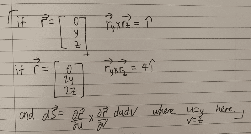

Thanks, that makes sense! What about this other example?
Handwritten notes: if r = [0, y, z] then r_y x r_z = i-hat; if r = [0, 2y, 2z] then r_y x r_z = 4i-hat; and dS = (dr/du x dr/dv) du dv where u = y and v = z.
It seems equally as valid to parameterise a surface as <0, 2y, 2z>, where y and z can be any number, to represent x = 0. Yet the results suggest otherwise!
The general case for [itex]f(x,y,z) = x = 0[/itex] is [itex]\mathbf{r} = y(u,v)\mathbf{e}_y + z(y,v)\mathbf{e}_z[/itex], with [tex] d\mathbf{S} = \mathbf{e}_x \left( \frac{\partial y}{\partial u}\frac{\partial z}{\partial v} - \frac{\partial z}{\partial u}\frac{\partial y}{\partial v}\right)\,du\,dv[/tex] and [tex] dS = \left| \frac{\partial y}{\partial u}\frac{\partial z}{\partial v} - \frac{\partial z}{\partial u}\frac{\partial y}{\partial v} \right|\,du\,dv[/tex] which you should recognise as the change of variable formula for a double integral, [tex] dy\,dz = \left| \frac{\partial y}{\partial u}\frac{\partial z}{\partial v} - \frac{\partial z}{\partial u}\frac{\partial y}{\partial v} \right|\,du\,dv.[/tex]

I don't follow, sorry. In one example I get ##\textbf{i}## and in the other example I get ##\textbf{4i}## for the same equation.
resolved: the parameterisation is different, so the bounds will change accordingly. All is fine! :)
