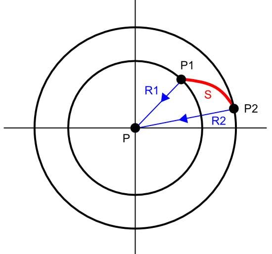

Hi,
What's the surface joining two points in a family of concentric spheres? Shown below is the general idea; it's actually optical. Two rays meet at P from P1 and P2, respectively, where each point comes from a different sphere. How do I find surface S if I know the coordinates of P1 and P2?
My best bet is that one can describe S as
[tex](x-h)^2+(y-k)^2=r^2 (\phi _i), \qquad R_1 \leq r (\phi _i ) \leq R_2 \mbox{ and } \phi_2 \leq \phi_i \leq \phi_1[/tex]
but that seems too abstract and 2D. I'm looking for something like an even asphere description with radius of curvature and coefficients if I know P1 and P2. How can I do that?

I want to confirm one thing, does the question ask you to find the surface by revolution of red line S?
I guess you can look at it that way, I'm looking for a surface in 3-space. It would be symmetrical about P. I was hoping this shape S would be a piece of another (simple) conic section.

I'm trying a 2D approach to this where all three points P1, P2, and P belong to one circle. It seems that surface S is just the 3D version of this 2D projection. I'm doing this the quick and dirty way using Geometer's Sketchpad - basically just changing the circle size and moving it around. That would mean the shape of S as a mirror would be a patch of a sphere.
but you told me the surface is by revolution of line S? did I misunderstand your question?
I concluded any 3 points (here P1, P2, and P) can be fit into a new circle and that a mirror prescribed by that new circle shape "C", truncated by the P1 P2 arc "S", should be able to focus light at point P, also on the same circle C. It's very easy to find that new circle in Geometer's Sketchpad by stretching and translating a custom circle until all 3 points are part of the circle.
Ultimately, it is indeed a patch of a sphere, so it is a surface of revolution of the line S. The key problem really was defining S. I'm sorry if I confused you. And the 3D surface comes out easily by bumping "S" out of 2D into 3D with a polar angle.
I think I should be all set. Thanks for the conversation. It helped me think.

doesn't seem to be complete. There exist an infinite number of surfaces that contain any finite number of points. There even exist a infinite number of planes that contain two points. Are you asking for a plane that contains two given points on the surface of two concentric spheres and the center of those spheres?
Hi,
I'm sorry for the confusing, perhaps incomplete question! I was really looking for a way to connect 3 points in a manner where 2 points could represent a mirror (i.e. surface S) focusing light at the 3rd point, as I represented in the drawing.
As I discovered, this is easiest done with interactive geometry software. You can draw 3 points and then insert a circle and play with its radius and position so that it overlays the 3 points. The fact that 3 points can not only define a plane (as most people immediately associate) but also define a circle is something I didn't quite appreciate before. Once you know the circle and its radius, you can turn that P1-P2 section into a 3D surface with a polar angle with respect to P, defining a solid angle. If you look for the definition of solid angle, it's similar to the resulting picture I'm taking about:
except that in the case I'm describing, the focus P is not at the center of the circle or sphere.
I hope this makes sense. I think I'm all set. Best regards.
That doesn't seem to have anything to do with your original question- and a "circle or sphere" does NOT HAVE a 'focus' although the point at, if I remember correctly, r/2 where r is the radius of the sphere, will act like a "blurry" focus. I order to have a true "focus" your mirror must be parabolic. A paraboloid can be approximated by a sphere with radius equal to twice the focal length of the sphere.
