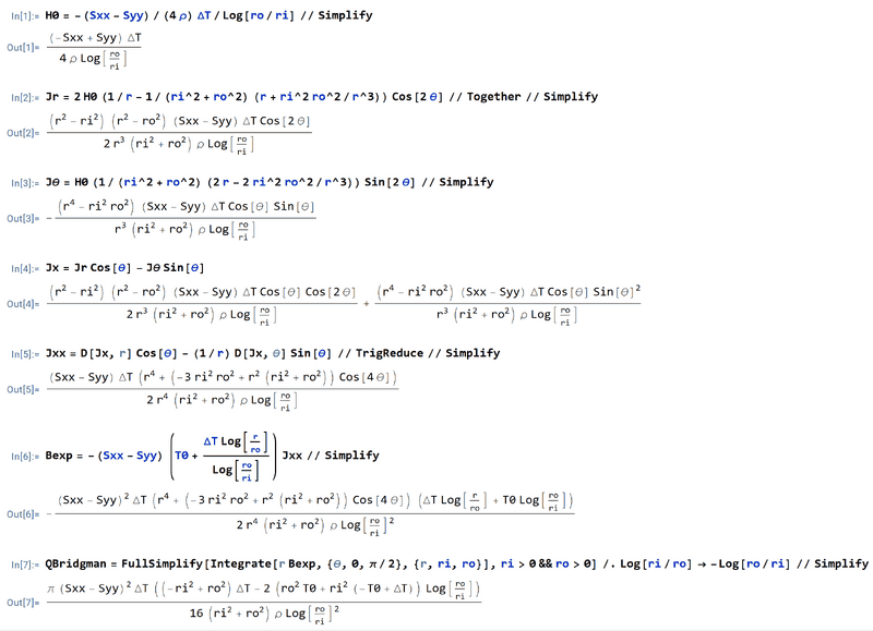

fluidistic said:
I wonder what Mathematica (or a better Simpy code) can yield, I strongly suspect the expression can be further simplified. Can someone confirm my result or show me a shoter one, which I could then compare?
Here is what Mathematica gives for your heat expression:
Cleaning up this result a bit, I repeat it below in LaTeX, along with the Joule heat from your previous thread https://www.physicsforums.com/threads/evaluating-integrals-derivatives-etc-with-simpy.1067101/ :$$Q_{\text{Joule}}=\frac{\pi\,\left(\Delta T\right)^{2}\left(S_{xx}-S_{yy}\right)^2\left[\left(r_{i}^{2}+r_{o}^{2}\right)\log\left(\frac{r_{o}}{r_{i}}\right)+r_{i}^{2}-r_{o}^{2}\right]}{16\,\rho\left(r_{i}^{2}+r_{o}^{2}\right)\log^{2}\left(\frac{r_{o}}{r_{i}}\right)}$$$$Q_{\text{Bridgman}}=\frac{\pi\,\Delta T\left(S_{xx}-S_{yy}\right)^2\left[\Delta T\left(r_{o}^{2}-r_{i}^{2}\right)-2\log\left(\frac{r_{o}}{r_{i}}\right)\left(\Delta T\,r_{i}^{2}+T_{0}\left(r_{o}^{2}-r_{i}^{2}\right)\right)\right]}{16\,\rho\left(r_{i}^{2}+r_{o}^{2}\right)\log^{2}\left(\frac{r_{o}}{r_{i}}\right)}$$Perhaps you can use this to compare to your SymPy expression after applying the suggestions of @pasmith in post #2?

Thanks for the suggestion. The expression is still very large after the substitution of the logs.
And the computations is taking forever (I will have to abort) when I specify both ri and ro to be real and positive.
Cleaning up this result a bit, I repeat it below in LaTeX, along with the Joule heat from your previous thread https://www.physicsforums.com/threads/evaluating-integrals-derivatives-etc-with-simpy.1067101/ :$$Q_{\text{Joule}}=\frac{\pi\,\left(\Delta T\right)^{2}\left(S_{xx}-S_{yy}\right)\left[\left(r_{i}^{2}+r_{o}^{2}\right)\log\left(\frac{r_{o}}{r_{i}}\right)+r_{i}^{2}-r_{o}^{2}\right]}{16\,\rho\left(r_{i}^{2}+r_{o}^{2}\right)\log^{2}\left(\frac{r_{o}}{r_{i}}\right)}$$$$Q_{\text{Bridgman}}=\frac{\pi\,\Delta T\left(S_{xx}-S_{yy}\right)\left[\Delta T\left(r_{o}^{2}-r_{i}^{2}\right)-2\log\left(\frac{r_{o}}{r_{i}}\right)\left(\Delta T\,r_{i}^{2}+T_{0}\left(r_{o}^{2}-r_{i}^{2}\right)\right)\right]}{16\,\rho\left(r_{i}^{2}+r_{o}^{2}\right)\log^{2}\left(\frac{r_{o}}{r_{i}}\right)}$$Perhaps you can use this to compare to your SymPy expression after applying the suggestions of @pasmith in post #2?
That's amazing, thanks a lot! Woah... There's a little typo in your latex (missing square for the S_xx and S_yy term).
This helps a lot.
Thanks, fixed it in post #3.
