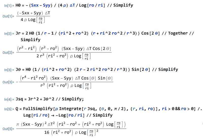

I would like to evaluate expressions with Simpy, but unfortunately I am unable to get a simple answer, the one I would get by hand if I had the time to perform all the computations. As far as I understand, Mathematica does it and yields 4 times the Simpy result, which is a big worry since I wish to trust the result I get.
I have the expression of a vector field ##\vec J## in polar coordinates, in a region of a quarter of an annulus (2D), theta goes from 0 to pi/2 and r goes from ri to ro. I need to compute ##\int _\Omega \rho |\vec J|^2d\Omega =\int_0^{\pi/2} \int_{ri}^{ro}\vec J \cdot \vec J rdrd\theta##.

If I take it from here, by hand, I reach ##Q=\pi (\Delta T)^2(S_\text{xx}-S_\text{yy})^2\frac{\left[ri^2-ro^2+(ri^2+ro^2)\ln\left( \frac{ro}{ri} \right)\right]}{16\rho(ri^2+ro^2)\ln^2(\frac{ro}{ri})}##. How can I reach this result using Simpy? Can someone else confirm that Mathematica or other software yields 4 times this result?

Actually, Mathematica gives precisely the same answer (no factor of 4 difference!):
Mathematica notebook with five In/Out cell pairs deriving H0, Jr, Jθ and Q; Out[5] is pi (Sxx - Syy)^2 ΔT^2 (ri^2 - ro^2 + (ri^2 + ro^2) Log[ro/ri]) over 16 (ri^2 + ro^2) ρ Log[ro/ri]^2.
