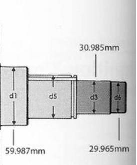

We need diagrams of the original and modified crankshaft and pulleys. And what is i/f?
i/f = interface

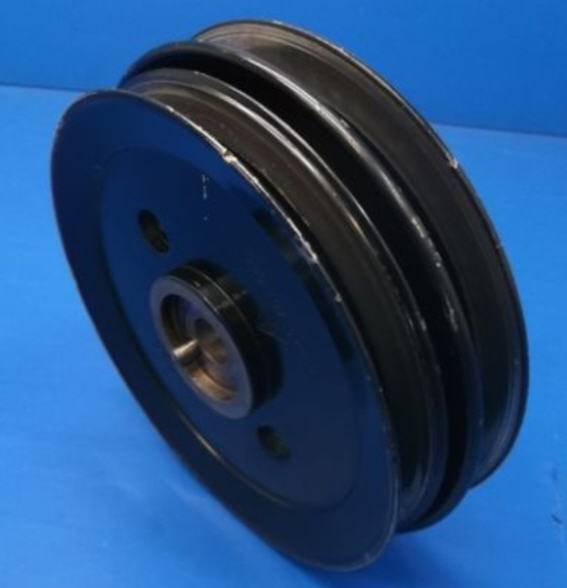

image 1 - tapered bore pulley illustrating removable center section - 6.4lbs

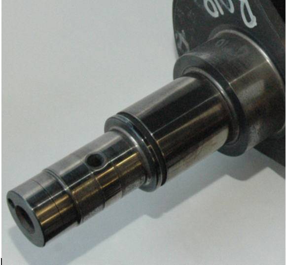

image 2 - Straight shaft end

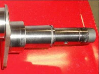

image 3 - Straight shaft end dimensions
image 4 - Tapered shaft – unpolished end is approximately 10mm and has been machined off and a new 5mm index pin hole drilled off center to crankshaft bolt bore to accept early style pulley, tapered to 27mm

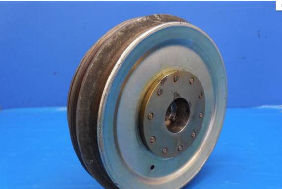

image 5 - straight bore pulley - 4lbs
Straight shaft bolt - M12x1.5x22 torqued to 170Nm = 125 ft lbs
Tapered shaft bolt - M14x1.5x40 torqued to 235Nm = 173 ft lbs

i would not hesitate to use the 14mm bolt. If you are not revving the engine past 6500 rpm should be ok. The small block chevy V8 race engine uses 7/16 bolt. This is straight shaft 8 pound damper bolt. I would safety wire it .second choice is lock tight thread locker. Personally i would put another shear pin in as well.
Unless I miss a down shift the 6500 rev limiter is still in place. The original 14mm bolt threads were deep enough down in the shaft that they were not compromised when the 10mm's of taper was removed. Think of the shaft as starting out as a straight or snub nose shaft (i.e. Porsche had the same shaft for years only the internals changed like stroke etc.) and Porsche decided to add 10mm's of taper to the end and at the same time increase the bolt size from 12 to 14mm and in turn increase tightening torque. They also went to a smaller 4mm index pin which contrary to my beliefs provides minimal shear strength (i.e according to after market pulley manufacturers trying to sell light aluminium racing pulleys and is primarily there for aligning timing marks) compared to the lock created by the torque on the bolt and the friction at mating surfaces. I was told that the snap back on a throttle blip is what may cause the pulley to back off and loosen, but again contrary to my beliefs I would think it would be the torque required to drive the fan, alternator and a/c compressor would be more signficant. The subsequent model was essentially the same engine (i.e 3.6L) but they beefed up the original lightened tapered shaft to get rid of the 4th order harmonics, did away with the 6.3lb harmonic damper / anchor and replaced it with a solid 2.5lb straight bore pulley. The length remained 10mm longer. Maybe the extra 10mm length is to provide more lateral support? All the earlier shafts and this one protrude from the engine case a few mm's and it's just the connection at the face of the crankshaft (i.e 29.965mm diameter) that creates the lock. I trust Porsche must have had a good reason to go to a longer tapered shaft but I don't know why so I came here to get help to crunch some numbers.
What you may do to the torsional systems response is very hard to predict. The really regrettable part about that is that, even if you have made a bad mistake, it will not be evident until enough revolutions have been acquired for torsional fatigue to give you a failure. I strongly suggest staying with the factory design unless you are able to do a full forced torsional fatigue analysis.
There is no question that the pin or alignment dowel is only there to maintain timing mark alignment. The tension in the axial bolt holds the taper tight and that taper locks the pulley to the shaft. Any movement at the taper I/F is bad and will shear the alignment dowel. Use as much of the existing taper as possible. Make sure the taper is clean before assembly, maybe use a locking compound.
