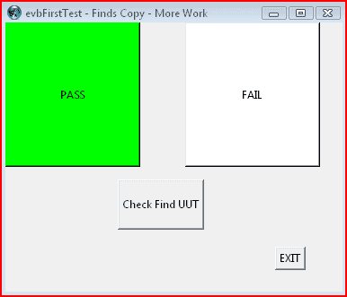

I'm improving an old Tcl/Tk test script of mine to be used in a simple test on the factory floor (previously I only used it in the R&D Lab for my own testing). With the current behaviour, I run the test and the Pass or Fail button changes from White to Green or Red, but I need to click the Pass or Fail button to reset the (background) color to White before running the test again. That's fine for my own work, but it will not be intuitive for the technicians on the factory floor.
I've been trying to get the Pass/Fail Buttons' background color to reset to White when re-running the test, but so far no joy. The code below runs, but the background color of the Pass/Fail Buttons does not change to White when re-running the test. Any thoughts? Or should I just change to some other display widget instead of using Buttons for the Pass/Fail indicators?
I'd expected this first part of the -command for "gobutton" to re-set the Pass/Fail Button colors to white:
-command { $passbutton configure -bg white; $failbutton configure -bg white;
Thanks!

Screenshot of a Tk window titled evbFirstTest - Finds Copy showing a green PASS button on the left, a white FAIL button on the right, a Check Find UUT button below, and an EXIT button at lower right.

I am not at all familiar with TCL/TK, but I have designed stuff like this. From a human engineering point of view, what if you added a "Reset" button to reset the color to white when pushed? It should be plenty intuitive for the technicians on the floor what to do with it.
Yeah, I'd thought of something along those lines too, but even so for some reason I'm having trouble changing the color of the Pass/Fail buttons back to white unless I actually click them. When I run the same lines (in almost the same way) as part of the gobutton command, it's not working. I'm hoping I'm just missing something simple. Thanks @kuruman :smile:

Ah. I was going to ask if this language of yours re-renders objects automatically. If not, once it's set, it will stay that way, unless the event loop is triggered again - by, say, re-running an initialize routine.
It looks like once the (finduut > 0) condition is met (a 'pass' run has occurred) the button goes green, and then when you push the run button again, the 'gobutton' command line that sets the button to white also sets it to green if (finduut > 0) is still true (and sets the failbutton to red if it isn't). Pushing the passbutton manually causes '-command { $passbutton configure -bg white }' to be executed, as provided in the 'set' statement for the button. I agree with those who suggested a reset button as a simple solution.

Hah! I figured it out finally.
Turns out that my code above was indeed changing the color of the buttons back to white for each re-test, but the display is not updated by default until the whole "gobutton" task finishes. So the buttons were resetting to white right before they got updated to the new test result color, which meant that continuous Pass or continuous Fail results didn't look like there was a return of the buttons to white ever.
The solution is to insert "update" into the sequence for the gobutton, right after I set the button colors back to white, and before the test code that takes a few seconds to run and display the result. The go button code below works much more intuitively now. :smile:
Code:
set gobutton [ button .gobutton -text "Check Find UUT" \
    -height 3 \
    -command { $passbutton configure -bg white; $failbutton configure -bg white; \
   update; \
   if {[finduut] > 0} { $passbutton configure -bg green } \
       else { $failbutton configure -bg red } } ]
Thanks everybody for your help and thoughts. It's great to have the PF to bounce this stuff off of... :smile:
