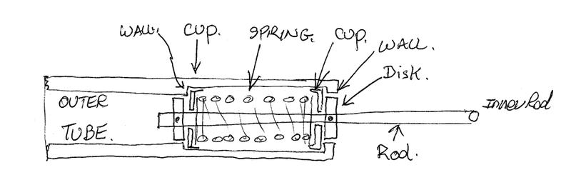

Hello folks,
I'm trying to find a spring that can act in both tension and compression, and return to a neutral (or zero) location when released.
What I'm thinking of is basically a shock, but without the damper. It needs to be a nearly instantaneous return. Google search is giving me nothing but automotive shocks, and I can't find any type of combination spring.
Anybody willing to throw me a few search terms for products? It's probably something simple, but I'm at a loss. It also needs to be fairly small. Maybe 1 to 1.5 inches of throw in each direction, and no more than 30lbf.

Here is a design for a bi-directional, linear, shock limiter.
The force needed to start moving is set by the zero length of the compression spring compared with the distance between disks. That solidly fixes the zero position of the system. Forces are bi-directional and symmetrical.
An outer tube has two internal walls, (or internal circlips in grooves), spaced by more than the required movement. An inner rod has two disks, ( or external circlips in grooves), attached with the same spacing as the disks above. Between the disks on the rod are two free floating cups that act as bushings to align the tube and rod. The ends of a compression spring rest in the cups. Those cups are limited in movement by either the tube internal walls or the disks on the rod.

This is great, thank you. That is exactly the solution we are looking for. Does this type of spring assembly have a name? I could probably manufacture one pretty easily, but purchasing one would be a much faster option.
Unfortunately it is the type of mechanism that is simply built into a product rather than purchased off the shelf to be bolted on.
I could give you a diagram of an easy to build unit if I knew better how your lever was mounted, actuated and connected.
