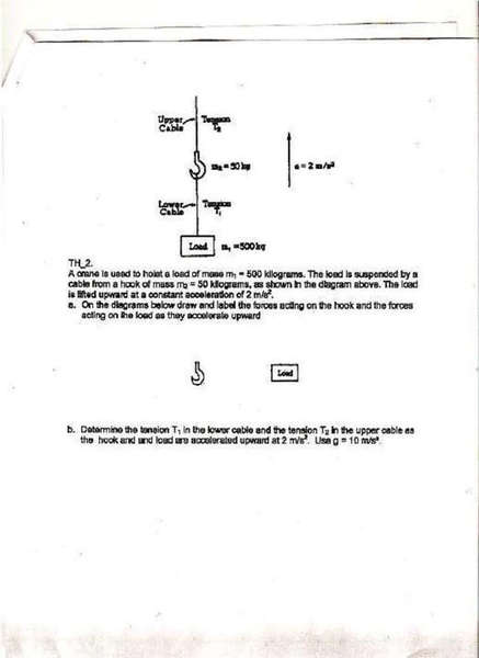

A crane is used to hoist a load of mass m1=500 kilograms. The Load is suspended by a cable from a hook of mass m2=50 kilograms, as shown in the diagram above. The load is lifted upward at a constant acceleration of 2 m/s^2.
b)Determine the Tension T1 in the lower cable and the tension T2 in the upper cable as the hook and load are accelerated upward at 2 m/s^2. Use g=10 m/s^2.
FYI: this is the 1982 Question B from an AP Test. So if you can find a link that has an explanation, that would be great. Or, you can solve it that would also be wonderful! thank you soo much
It'd be nice to see the diagram as,it may show some information not stated and also,you can take a stab at it and we can try to help you out with it.
i don't have a scanner, so I'm sorry but i don't know how i can show you the diagram. i tried to do this problem, i really need help
erm i sent a pic to you
let me know if you can help

for the second part i used
T1= M1 (g+a)
T2= (M1+M2)(g+a)
it's the first part that I'm not sure about
i get that the force of gravity points down
but what other forces are on it?
Tension forces.
The only forces to consider are weight and tension. Weight acts downwards so tension must act upwards.
