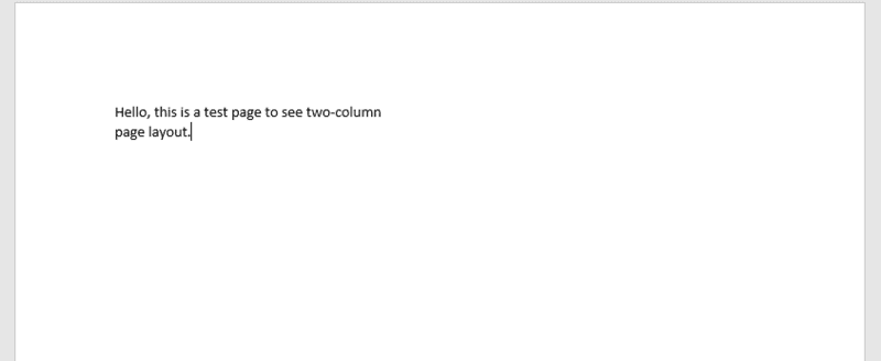

So, it's not like MS Word where as your text gets arranged in two columns as you type as show below.
