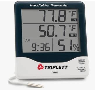

You can help settle the arguments by getting an indoor-outdoor thermometer and proposing a policy: If outside temperature is better than inside temperature, then open windows. Otherwise, close windows. Image of typical thermometer randomly grabbed from internet:
