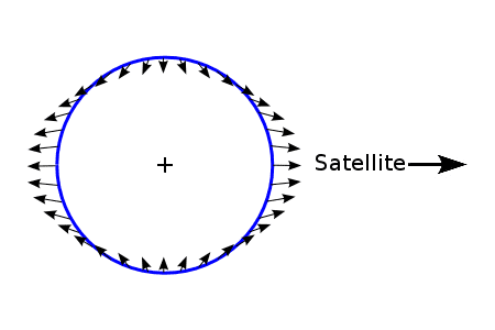

This image shows that on the right (the moon side of the earth) the gravitational force is greater. And on the left, the inertia is larger, and so that side of the planet does not accelerate as fast towards the moon. And in the centre, they balance out perfectly.
*This also includes the Earth's gravity.*
Centrifugal or gravity or both?
That image most certainly does not include the Earth's gravity. Think about it: If the net force was outward the oceans would long ago have flown off the face of the Earth. You took this image from the Wikipedia article on http://en.wikipedia.org/wiki/Tide#Forces". The caption below the image reads
Figure 7: The Moon's (or Sun's) gravity differential field at the surface of the Earth is known as the tide generating force. This is the primary mechanism that drives tidal action and explains two tidal equipotential bulges, accounting for two high waters per day.​
Since you are so won't to quote Wikipedia, why did you not use this, from the same section of the Wikipedia article referenced above?
The tidal force produced by a massive object (Moon, hereafter) on a small particle located on or in an extensive body (Earth, hereafter) is the vector difference between the gravitational force exerted by the Moon on the particle, and the gravitational force that would be exerted on the particle if it were located at the center of mass of the Earth. Thus, the tidal force depends not on the strength of the gravitational field of the Moon, but on its gradient (which falls off approximately as the inverse cube of the distance to the originating gravitational body; see NASA).​
Note well: That differential force is exactly what I described with mathematics in post #11. That differential force is also exactly what is depicted in the referenced image.Edit:
The cited image is a tad too symmetric. The author of the image (source attribute on the Wiki commons page is "(Differential gravity field that causes tides Source:me {{GFDL}} en:Tide)") plotted the first-order approximation to the tidal force. Assuming a non-rotating frame with the x-axis instantaneously co-aligned with the Earth-Moon vector, the tidal force at some point r on the Earth's surface to first order is
[tex]\mathbf{a}_{\textrm{tidal}} \approx<br /> \frac {GM_{\textrm{moon}}}{R_{\textrm{earth}\to\textrm{moon}}^3}<br /> \bmatrix 2 & 0 & 0 \\ 0 & -1 & 0 \\ 0 & 0 & -1 \endbmatrix \mathbf r[/tex]
Your right, it doesn't include the Earth's gravity. (I added that at the end because I saw that the arrows at the side of the Earth where pointing inwards, but I now see why this is)
In terms of forces - Just gravity.
It is the inertia of the water that resists the acceleration due to gravity.
The inertia is constant for each part of the earth. But the gravity is not constant, so the acceleration of the oceans towards the moon is different from one side of the Earth compared to the other.
