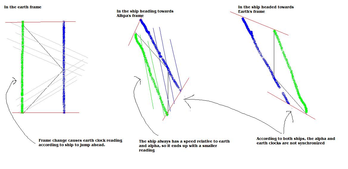

  • #108
I always think a picture helps with the twin paradox: here's a really bad one.
http://www.vbforums.com/attachment.php?attachmentid=33201&stc=1
The black line is the ship (or ships, whatever)
The green bar is the earth
The blue bar is alpha
The grey bar are 'now' lines for the spaceship: Consider them snapshots of everything happening in the rest frame of the ship
Similarly the blue and green lines are snapshots for Earth and alpha
The red lines are also snapshots for Earth and alpha.
Ignore the picture on the right, it's... umm not consistent at all! (notice how alpha is on the wrong side...)
The main thing to notice is the left picture, how the 'now' lines jump when the ship(s) speed changes.
This isn't a faster than light effect because the ship can't know about this until light reach it from that frame... It's like saying "oh, if I rotate a spotlight, the circle of light can exceed c" but that's because the 'circle of light' isn't a particle... it's an abstract thing.
