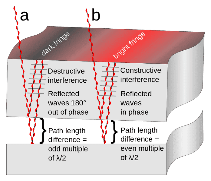

The bright bands are formed by constructive interference between the light rays reflected from both surfaces, while the dark bands are caused by destructive interference. So, if I graph the waves, (B) interferes constructively and (C) interferes destructively. But wouldn't you need both types of interference to see the bands on the film? I'm having trouble relating my thought process to the solutions presented in the problem.

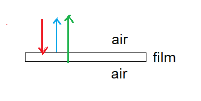

The phase of the incident wave changes by pi upon reflection, while the wave entering into the film has no phase change when reflected from the film-air interface. If the film is very thin, the phase change due to the thickness can be ignored, so the phase difference between the reflected waves is pi. is it constructive or destructive interference?

Your graph does not correspond to the situation. You have a film with air on both sides, and not an air layer between glass plates.
When do you get dark and bright bands on the film? Is it possible with a film of homogeneous thickness?
