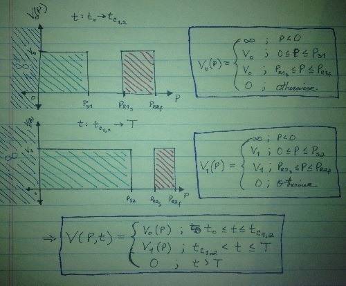

Hi guys,
I'm trying to solve the S.E. For a potential that's time dependent but the time variable is not continuous. Essentially the potential is a finite square well and it shifts over time but not continuously.
I.e. At time 0<t<t' it's a finite square well centered about some x'
At time t'<t<t" it's a finite square well centered about x"
And so on. All the t's and x's are known numbers. Also it's not exactly a finite square well, here's an example at some time:
0<t<t' => V(x) = {∞ ; x<0 , V0 ; 0<x<P or P'<x<P" , 0 ; otherwise}
Where P, P', P" and V0 are known constants.
I thought I might be able to solve each situation time-independently and then just multiply by the time in each well over the total time but I don't think I can do that. If someone could let me know how to go about tackling this problem I'd appreciate it! I've taken 2 semesters of QM but am a little rusty. Just having trouble figuring out the plan of attack here (it's not for HW just something I'm working on where I'm modeling a process as a particle in the types of potentials shown).
Thanks!
A picture's worth a thousand words... here's the scenario if there were only two sets of times, hence the potential function only changes once:
  • Handwritten notes showing a piecewise potential V(P,t) with two time intervals: V0(P) for t0 to tc1,2 and V1(P) for tc1,2 to T, plus V=0 for t greater than T, with step-shaped plots of each potential against P.
