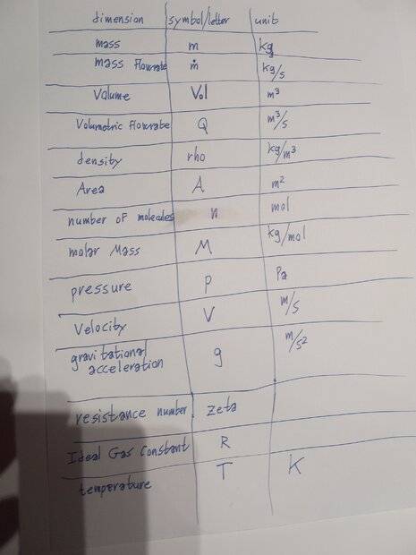

Constant temperature (however I might want to expand the calculations to include this too, after I have nailed this first part).I decided to carefully hand-write my formula-gymnastics, and take a picture, in the hope that they will be easier for you to read than a typed up version:

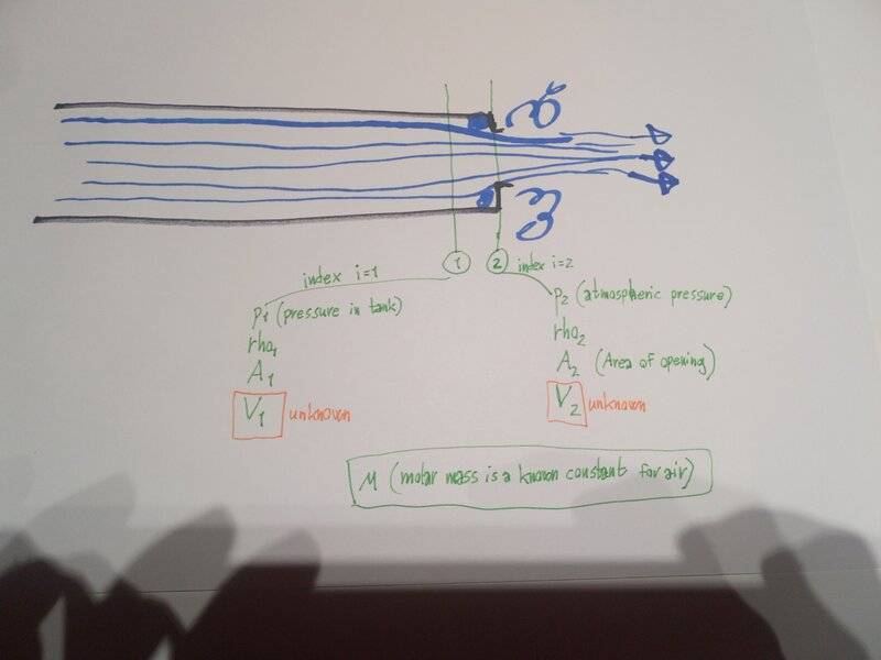

Hand-drawn diagram of gas flowing from a pipe or tank through an opening to the atmosphere; labels 1 and 2 mark the tank and exit, with p1, rho1, A1, V1 unknown on the left and p2 (atmospheric pressure), rho2, A2 (area of opening), V2 unknown on the right, and M (molar mass is a known constant for air) in a box below.

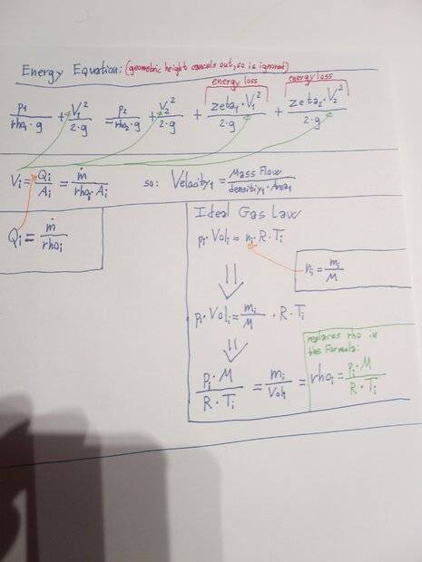

Handwritten derivation of the energy equation with geometric height ignored, showing pressure, velocity and loss terms, mass flow continuity, and the ideal gas substitution replacing density with p M / (R T).
(Note: The resistance numbers I am referring to is simply going to be looked up on a table, based on the geometry of the opening)
As you can see from my scetch, I am using an energy-equation (similar to Bernoulli), and comparing 2 points, with index 1 and index 2.
Index 1 is inside the cylinder, just far enough inside that the flow hasn't started contracting yet towards the opening.
Index 2 is just at the end of the opening, so I am assuming atmospheric pressure at this point.
The problem is that I have an unknown speed at both Index 1 and Index 2 (two unknowns), and I cannot assume the same volumetric flow at both points, because the densities are changing.
I can however assume Conservation of mass, and by converting the velocities to mass-flows, I solve both of these problems.
The idea is then to calculate the mass flow at the starting point, calculate the mass "lost" from the cylinder during a small period of time (1/1000 second or similar), and then recalculate internal pressure based on this new total mass, and then start over again with a new mass-flow calculation, and so on in a loop, until some predetermined pressure has been reached.What do you think? Am I on the right track, or did I make some mistakes in my basic thinking and assumptions?
  • Handwritten notes on paper: the energy equation with geometric height ignored, showing pressure, velocity and energy loss terms, then V_i = Q_i/A_i = m-dot/(rho_i A_i), Q_i = m-dot/rho_i, and the ideal gas law with rho_i = p_i M/(R T_i).

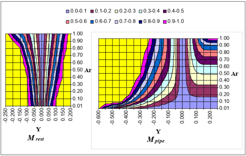

I did solve a similar problem in the past - flow through an engine valve between a cylinder and a pipe. Here are the results put graphically for the Mach numbers in the restriction and the pipe:
Two contour plots side by side, each with a colour legend of bands from 0.0 to 1.0. Left: M_rest against Y (-0.250 to 0.200) and Ar (0.01 to 1.00). Right: M_pipe against Y (-0.600 to 0.200) and Ar (0.01 to 1.00).
Where:
$$Ar = \frac{A_{rest}}{A_{pipe}}$$
$$Y = \left(\frac{1}{2.7908k-2.795488}\right)\left(\frac{2X_{pipe\ 0}-1}{X_{cyl}}-1\right)$$
Furthermore:
$$X_n = \left(\frac{p_n}{p_{ref}}\right)^{\frac{k-1}{2k}}$$
##A_n## is the area of ##n##, ##k## is the specific heat ratio (the presented equation for ##Y## is valid for ##1.2 \leq k \leq 1.45##), and, in your case, the reference pressure would be the atmospheric pressure which is the "cylinder" pressure as well. (##p_{ref} = p_{cyl} = p_{atm}##)
Your case would represent a positive value for ##Y##. A negative value would mean the flow would be from the atmosphere (the "cylinder") to your pipe. The mass flow rate through the restrictor would be:
$$\dot{m} = \rho_{rest}v_{rest}A_{rest} = p_{atm}{X_{rest}}^\frac{k+1}{k-1}\sqrt{\frac{k}{RT_{pipe\ 0}}}M_{rest}A_{rest}$$
##R## being the specific gas constant and ##p_{rest} = p_{cyl}## (meaning ##X_{rest} = 1)## if ##M_{rest} < 1##. If ##M_{rest} = 1## then:
$$X_{rest} = \frac{\frac{2}{k-1} \left(2X_{pipe\ 0}-1\right)}{\frac{2}{k-1} + M_{pipe}} \left(M_{pipe}\frac{A_{pipe}}{A_{rest}}\right)^\frac{k-1}{k+1}$$
This work was done based on the theory found in Design and Simulation of Four-Stroke Engines by Gordon P. Blair.
I'm leaving off the equations for calculating the reflected pressure which would just be too much and useless without a more complex and lengthy context explained.
So assuming the initial conditions ##Ar = 0.80## and ##\frac{p_{pipe\ 0}}{p_{ref}} = 4## (then ##Y = 0.394##), you should have a choked flow with ##M_{rest} = 1##, ##M_{pipe} \approx 0.56## and ##X_{rest} = 1.2186##. (So ##p_{rest}## is basically equal to the pressure in the pipe.)
Edit: I now realize that ##Ar = 0.64## in your case, meaning ##M_{pipe} \approx 0.41## and ##X_{rest} = 1.234##.
