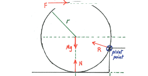

berkeman Admin Messages 69,838 Reaction score 25,774 Nov 6, 2013 #2 Welcome to the PF. Please show us your FBD...
northernwind Messages 12 Reaction score 0 Nov 6, 2013 #3 Thank you for the welcome and reply. Here is my diagram: Attachments Screen Shot 2013-11-06 at 8.51.38 PM.png 11.1 KB · Views: 503
SteamKing Staff Emeritus Science Advisor Homework Helper Messages 12,828 Reaction score 1,673 Nov 7, 2013 #4 When the tire starts to pivot about the curb, what is the value of N? Have you written your equations of static equilibrium when the tire is off the ground?
