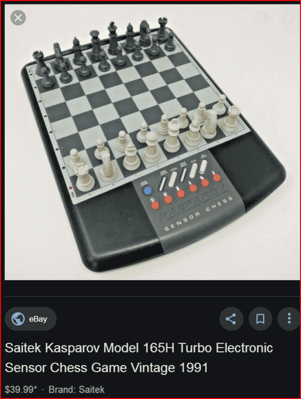

Alternately, you could use a technique that my first computer chess board used (from Radio Shack about 30 years ago). It had a switch under the plastic fabric at each square, and to let the computer know your move, you pressed the piece down on it's existing square to signal the start of the move, and then pushed it down on its new square to signal the end of the move. The board made a "beep" sound with each button push to give tactile/audible feedback.
EDIT -- I found this picture of a similar-looking chess game as an illustration. But I see now that they are advertising some sort of "sensor" capability to track the pieces. It may just be the same pushbutton technique with the addition of magnets in the pieces to actuate reed relays under the squares, or it may be more comprehensive. It may be worth it for you to look more into this game to see what they are calling the "sensor" capability/feature:
http://www.spacious-mind.com/html/sensor.html
