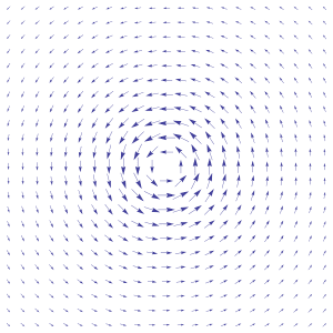

A vector field is a map with vector domain and range. Think about the classic ##\mathbb{R}^2 \rightarrow \mathbb{R}^2## map. If you just do ##V^i(x) \mapsto R^{ij} V^j(x)## you are rotating the range vector while keeping it in the same position. That means you don't get a rotated vector field, but a completely different field. Think about the classic curling field:
If you do ##V^i(x) \mapsto R^{ij} V^j(x)## with a 90° rotation matrix, you obtain a central vector field! While if you actively rotate the whole field, sure the resulting vector is rotated 90° but referred to the old vector function in the old position.
Edit: maybe I see where your doubt lies. For instance, you don't do ##V^i(x) \mapsto R^{ij} V^j(R x)## because the right hand side V would have to be a different function from the left hand side V to be the actively rotated field. Also, don't see in the correct formula ##V^i(x) \mapsto R^{ij} V^j(R^{-1} x)## the resulting field as a function of ##R^{-1}x##, see it as a function of ##x##. Then it will make sense.
