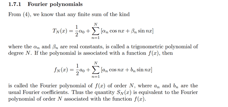

what is the difference? It seems like in T, you choose the RHS first, but in f, you choose the LHS first. Is this the only difference?
Because the Fourier coefficients of f is derived in a standard way, right? As in, couldn't I derive the coefficients for T in the same way as I did for f? In which case, isn't T and f the same?

I don't see any difference other than a Fourier polynomial is a trig polynomial for a specific function.

That ##f(x)## in the integrand has no subscript ##N##. Notice in your OP its ##f_N(x)## that is the Fourier Polynomial. I don't claim to know what the fuss is about with saying ##T_n(x)## is different from ##f_N(x)## but in general with the method of least squares you are looking for the function that minimizes error between your chosen function ##f(x)## and the data. My guess is that in the first definition you present it is supposed to be ##F_N(x)## not ##f_N(x)##, a typo. If I'm talking out my backside I apologize, but I think in the very least it's worth noting this discrepancy.

Is any trigonometric polynomial its own Fourier polynomial? I think it would be. And clearly any Fourier polynomial is a trigonometric polynomial.

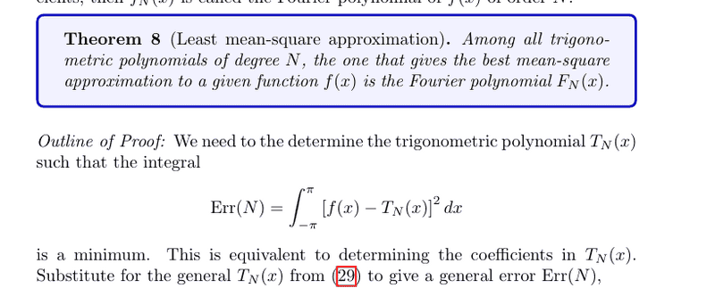

They seem to be saying in Theorem 8 that the coefficients of the Fourier Polynomial ##a_n,b_n## of ##F_N(x)## are special; they would be found by minimizing ##Err(N)## w.r.t. ##\alpha_n,\beta_n##?
I suspect the difference is subtle and mostly semantic. In the trigonometric polynomial ##T_n(x)## is defined by the choice of ##\alpha_n## and ##\beta_n##. In the Fourier polynomial ##a_n## and ##b_n## are determined by the definition of ##f(x)##. The Fourier polynomials would then be a subset of all trigonometric polynomials defined by the function ##f(x)##.
Yes. The OP says that the Fourier polynomial coefficients for a function are the same as the usual Fourier series coefficients as far as the Fourier polynomial goes. So the Fourier polynomial is just a truncated Fourier series. My question is whether the truncated Fourier series coefficients of a trigonometric polynomial are identical to the coefficients of the trigonometric polynomial.

Perhaps this analogous example might help:
We know that any finite sum of the kind​
$$p_N(x) = \alpha_0 + \alpha_1 x + \cdots + \alpha_N x^N,$$ where ##\alpha_i## are real constants, is called a polynomial of degree ##N##. If the polynomial is associated with a function ##f(x)##, then​
$$f_N(x) = a_0 + a_1 x + \cdots + a_N x^N$$ is called the Taylor polynomial of ##f(x)## of order ##N##, where ##a_i = f^{(i)}(0)/n!## are the usual Taylor series coefficients.​
The difference in the text is that ##T_N(x)## is a generic trigonometric polynomial and the Fourier polynomial ##f_N(x)## is a specific trigonometric polynomial where the coefficients are the usual Fourier coefficients from the Fourier series.
It's not obvious that the Fourier polynomial of order ##N## obtained by truncating the Fourier series is the trigonometric polynomial of degree ##N## that best approximates the function ##f(x)## in the least-squares sense. Theorem 8 says it is.

My understanding is that , given a basis for ##S:=L^2[-\pi, \pi]## ( as an example); here the basis being ##B:=\{\pi, cos(nx), sin(nx); n=1,2,3,...\}##, the orthogonal projection of any ##f ## onto the space spanned, generated by B minimizes the (##L^2##) , aka, mean-squared, distance between f and the series ##\Sigma_{n=1}^{\infty} a_0 +a_ncos(nx) + b_n sin(nx) ## (i.e., the vector space generated by ##S##). And the Fourier coefficients are precisely the result of that projection. As such, the Fourier coefficients provide the best approximation. Maybe @mathwonk can comment on it.

Hi, the Fourier Coefficients guarantee the best approximation in the mean-square sense, (##L^2 ##) to your choice of ##f## under the basis ##\{ cos(nx), sin(nx), \pi\} ##. Thus they are the subset of Trigonometric coefficients ##a_n, b_n ## that minimize ## || f - [\Sigma_{n=1}^{\infty} a_0 + a_nCos(nx) +b_n Sin(nx) ] || ##. It follows from the result that the orthogonal projection of a vector (function, here) minimizes the distance from the vector onto a subspace.

I think it is more accurate to say "Fourier polynomial of order N of the function ##f(x)##".
Every trigonometric polynomial is the Fourier polynomial of itself. Clearly, every Fourier polynomial is a trigonometric polynomial.
So the only difference is when a specific function, ##f(x)##, is introduced. Then a given trigonometric polynomial of degree N may or may not be the Fourier polynomial of order N of the function ##f(x)##.
