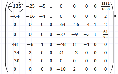

I turned all equations into matrix form and plugged it into an online matrix calculator. The matrix form is this:
Augmented matrix with 8 rows and 9 columns for cubic spline coefficients; the first entry -125 is circled, and the last column reads 1561/1000, 2, 2, 64/25, 0, 0, 0, 0 with an arrow linking rows.

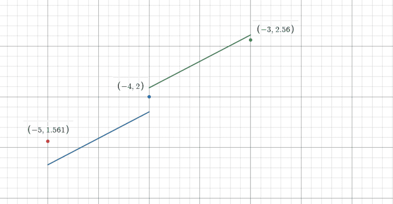

If I try to plot it, it looks *almost* right but it's certainly not what I expected.
I assume it's a calculation problem, maybe it's even trival but I can not find it.
The plots look like below by the way, and you can find them using this link.
Graph of two line segments on a grid: a blue segment from (-5, 1.561) up to (-4, 2) and a green segment from (-4, 2) up to (-3, 2.56), with the three points labelled.

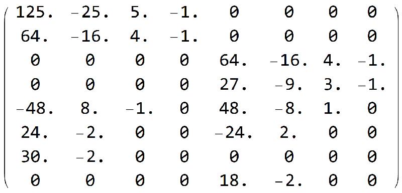

Here's the 8x8 matrix I get in Mathematica using your method of solution:
8 by 8 matrix of numbers in Mathematica output, with rows of coefficients including 125, -25, 5, -1, 64, -16, 4, -1, and zeros, plus entries 27, -9, 3, 48, -8, 1, 24, -2, 30, 18, -24, and 2.

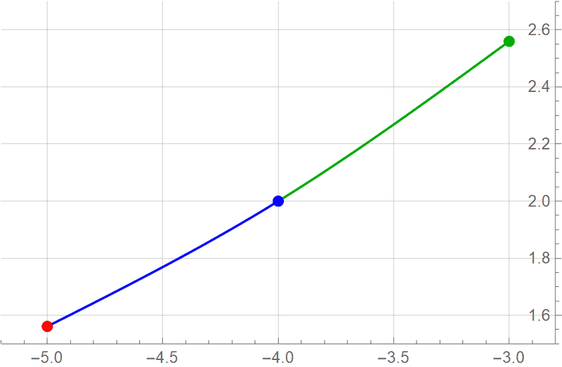

Using this to solve your system results in the cubic-spline plot:
Line graph of a cubic spline through three points: red at (-5, 1.56), blue at (-4, 2.0) and green at (-3, 2.56), with blue and green segments curving upward on a grid.
This looks correct to me.

Haha what I silly mistake I made, I forgot a parenthesis when feeding the equations into the matrix calculator. All worked out now, thank you!
