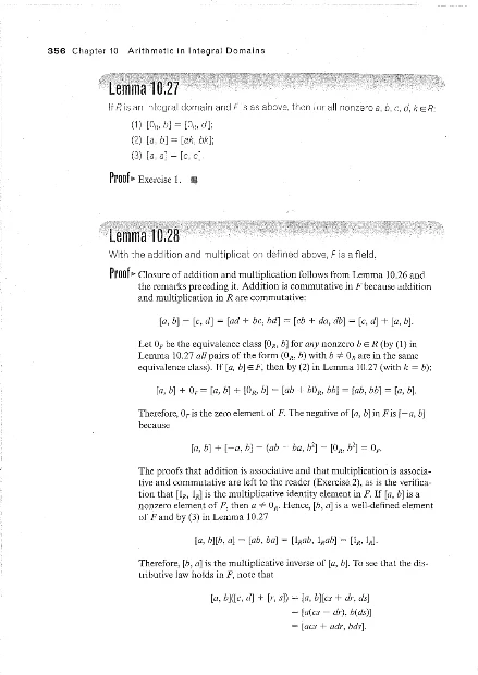

@fresh_42 In the MSE author's solution, where he said
'The prime ideals contained in ##\mathfrak{p}## correspond 1:1 to the prime ideals in the localization ##R_{\mathfrak{p}}##'
Does he mean theorem 3.3.15 in the first screenshot?
Also when i said if the problem can solve without mentioning anything from localization. I mean if one sticks to the the content of section 10.4 in the next few screenshots from Hungerford's abstract algebra text, can the problem be solved only using what is in the seven pages below?
Thomas W Hungerford - Abstract Algebra An Introduction-Cengage Learning p 374 - 380_pages-to-...webp
