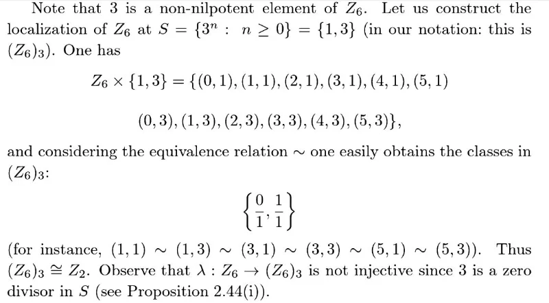

How does one determine all the equivalence classes and how many there are in the case of localising a non integral domain at a prime?

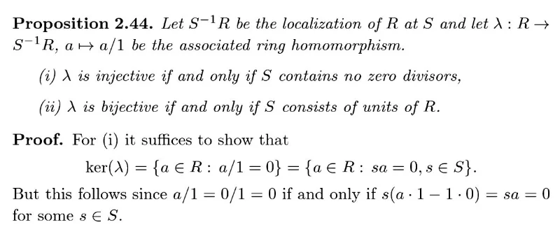

The two screenshots below are taken from the book Fundamentals of Modern Algebra A global Perspective by: Robert G Underwood
Screenshot 1
Typeset text of Proposition 2.44 with a proof: the localization map λ: R → S⁻¹R, a ↦ a/1, is injective iff S has no zero divisors, and bijective iff S consists of units of R; the proof shows ker(λ) = {a ∈ R : sa = 0 for some s ∈ S}.
Screenshot 2
Textbook page on localization of Z6 at S = {3^n : n ≥ 0} = {1, 3}, listing Z6 × {1, 3} as pairs, equivalence classes {0/1, 1/1} in (Z6)3, and the conclusion (Z6)3 ≅ Z2 with λ not injective.
The two screenshots above concerns localizing a non integral domain at a prime; in the second screen shot, the example given is ##(Z_6)_3## which denote the multiplicative closed set ##Z_6\times\{1,3\}=\{(0,1),(1,1),(2,1),(3,1),(4,1),(5,1),(0,3),(1,3),(2,3),(3,3), (4,3),(5,3)\},## with the equivalence relation ##\sim## define as ##(a,b)\sim(c,d)\text{ iff for some } s\in S
\text{ for which }s(ad-bc)=0.## and the equivalence classes in ##(Z_6)_3:## ##\{\frac{0}{1}, \frac{1}{1}\}##.
What I would like to know are the following:
1. How did the author determine that ##\{\frac{0}{1}, \frac{1}{1}\}## are the only equivalence classes? I mean the reason ##\frac{0}{3}## is not an elements of the equivalence classes listed because we are in ##\pmod 6?##
2. Also, for any other a large non integral domain integer ring ##n## along with large prime ##p##, say if we have ##(Z_n)_p##, where ##n## is in the couple hundred trillion, and ##p## has couple hundred billion digits, are there algorithms that can systemically determine all of its equivalence classes, and also upper and lower bounds for how many there are?

@martinbn ops you are right. Are there ways to show that ##\{0/1,1/1\}## are the only equivalent classes in the localisation?
Yes, you check that any other a/b is equivalient to one of these two.
@martinbn I should have asked what about the case ##\frac{1}{3}##, but ##\frac{1}{3}\sim \frac{1}{1}.## Actually, the way the set ##S,## is it defined in general as ##S=\{p^n: n\geq 0\}## and is always equal to ##\{1,p\}## for ##p-##prime?
Also, just to make sure I understand the example properly, if I want to determine the set of equivalence class for ##(\Bbb{Z}_n)_p##, where ##n## is some large composite number, say ##n=100##, and ##p=41##, then I would have the set of equivalence classes ##\{\frac{0}{1},\frac{1}{1}\},## and ##\Bbb{Z}_100\times \{1,41\}=\{(0,1),(1,1),(2,1),\ldots, (99,1),(0,41),(1,41),(2,41),\ldots,(99,41)\}##?
Note: a/1 ≈ 0/1 iff 3a = 0 in Z/6. Hence the kernel of the map Z/6-->S^-1(Z/6) is {0,2,4} and the image is {0/1, 1/1}. Hence every element of the localized ring is equivalent to one of 0/1, 0/3, 1/1, or 1/3. But 0/1 and 0/3 are equivalent and 1/1 ≈ 1/3 since 3.(3.1-1.1)= 0 in Z/6.
In your last example, note 41 is not a zero divisor in Z/100, so the map from Z/100 to the localization is injective. That's a start. Thus the first 100 of your fractions are all different, and so are the last 100. But some of the first 100 are equivalent to some of the last 100. Do you see how many?
Or you could just ask yourself what the units are in Z/100, and use the Proposition 2.44,(ii), that you cite.
Hint: what is (41).(61) ?

The example they gave on localizing Z/6 is a case where the criteria do not seem to apply, but actually they can be tweaked until they do apply. Namely since the kernel of the map Z/6-->S^-1.Z/6 is {0,2,4}, the result seems to be that we are essentially localizing the quotient (Z/6)/{0,2,4} ≈ Z/2 = {0,1}, at the multiplicative set {1,3}/{0,2,4} = {1} which is a unit in Z/2, so the result, again by 2.44(ii) is isomorphic to just Z/2 = {0,1}.
This technique of first forming the quotient of R by the ideal of elements which are annihilated by elements of S, always allows us to get into the situation of 2.44(i), where the natural map is injective, but not always in the situation of 2.44(ii). (A general principle is that forming quotients "commutes with localization".)
So in this example, all our questions are answered by, just thinking about and using, the tool given in the proposition.
As exercise, you might try to compute the result of localizing Z/100 at powers of 2, or powers of 3, or powers of 5, or powers of 6. (my answers: Z/25, Z/100, Z/4, Z/25.)

We need a multiplicative closed set ##S## to build ##S^{-1}R## and further require ##1\in S.##
Now let us assume that ##P\triangleleft R## is a prime ideal. Then we define ##S=R\setminus P.## Since ##1\not\in P## we have ##1\in S.## How about the multiplicative closure? Say, we have ##a,b\in S.## This means that ##a\not\in P## and ##b\not\in P.## Assume that ##a\cdot b\not\in S.## Then ##a\cdot b\in P.## By the definition of a prime ideal, this means that ##a\in P## or ##b\in P## (or both). However, we already know that neither of them is in ##P.## Hence, our assumption ##a\cdot b\not\in S## is false, i.e., ##a\cdot b\in S## and ##S## is multiplicative closed.
This means that whenever we have a prime ideal, then its complement set in a ring is a multiplicative closed set and may serve for a localization. In your example of ##R=\mathbb{Z}_{100}## we have a prime ideal ##5\mathbb{Z}/100\mathbb{Z}\triangleleft \mathbb{Z}_{100}## and we can localize with the multiplicative closed set ##S=\{a\in \mathbb{Z}_{100}\,|\,a\not\in 5\mathbb{Z}\}.## This gives us all quotients with a denominator that is not divisible by ##5.## Same with ##2\mathbb{Z}/100\mathbb{Z}\triangleleft \mathbb{Z}_{100}## which results in all odd denominators.
Note that you cannot combine these two since ##10\mathbb{Z}/100\mathbb{Z}\triangleleft \mathbb{Z}_{100}## is not a prime ideal. Prime ideals are a natural source to define multiplicative closed sets by their set-theoretical complement.

I don't know what your equivalence relation is. I assume we are still talking about ##S^{-1}R,## a localization, and not quotients, which I thought you meant by that horizontal line when I began my answer.
This means we consider ##R\times S## and define
(r,s)\sim (r',s') \Longleftrightarrow (rs'-r's)\cdot t=0 \text{ for some }t\in S.
Take ##R=\mathbb{Z}_{24}## and ##S=\{1,3,9\}.## Then there are ##72## elements in ##R\times S.##
First, start with the example ##\mathbb{Z}_6\times \{1,3\}## with ##12## elements and figure out which are equivalent and, then do the same for ##\mathbb{Z}_{24}\times \{1,3,9\}.##
Maybe you were right and the example ##\mathbb{Z}_6\times \{1,3\}## has indeed only two equivalence classes, but I do not see it without calculations.

elias001 said:
Given what your corrections are at (3) about ##S=\{p_i^m: m\geq 0\}=\{1,p_i,p_i^2,\ldots,p_i^m\}##, would (4) be changed to
##\Bbb{Z}_n\times \{1,p_i,p_i^2,\ldots,p_i^m\}=\{(0,1),(1,1),(2,1),\ldots,(n-1,1),(0,p_i),(1,p_i),(2,p_i),\ldots,(n-1,p_i),(0,p_i^2),(1,p_i^2),(2,p_i^2),\ldots,(n-1,p_i^2),\ldots,(0,p_i^m),(1,p_i^m),(2,p_i^m),\ldots,(n-1,p_i^m)\}?##
Yes, but nobody would write that. Plus, it isn't clear how ##m## is defined. I suggest ##R\left[\frac{1}{p_i}\right]## because that is what the brackets ##\left[\cdot\right]## mean. And you don't have to bother equivalence classes, since the new ring inherits the arithmetic rules from ##R.##
If ##R## is an integral domain, the equivalence relation is particularly easy:
(r,s^n)\sim (r',s^m)\Longleftrightarrow \left(rs^m-r's^n\right)s^k=0 \Longleftrightarrow \left(rs^m-r's^n\right)=0 \Longleftrightarrow rs^m=r's^n
because ##s^k\neq 0## for all ##k## and ##R## is an integral domain, which allows us to "divide" by ##s^k.##
Things are a bit more complicated if ##R## is not an integral domain, since ##s^k## could be a zero divisor, so that we may not cancel it.
elias001 said:
For (5), I am referring to localization when asking about the number of equivalence classes. I thought there must be some convenient ways to list and count them, since they there are repeats. For large composite ##n## and localization at a large prime ##p##, How does one list them all, make sure there are no repeats, and give a number for counting the number of equivalence classes.
See my previous remark.
Let's see what my example says. We have ##R=\mathbb{Z}_{24}## and ##S=\{3^n\,|\,n\in \mathbb{N}_0\}=\{1,3,3^2\}## since ##3^3=27\equiv 3\pmod{24}## and we run in circles by all other powers. The equivalence relation is defined by
\begin{align*}
\left(a,3^n\right)\sim \left(b,3^m\right) &\Leftrightarrow \left(3^ma-3^nb\right)3^k=0 \;\text{ for some }\;k\in \mathbb{N}_0\\
&\Leftrightarrow 3^{m+k}a-3^{n+k}b=0 \;\text{ for some }\;k\geq 0\\
&\Leftrightarrow 3^{m+k}a=3^{n+k}b\;\text{ for some }\;k\geq 0
\end{align*}
This is a bit nasty to check for all possible values ##k,m,n\in \{0,1,2\}## and ##a,b\in \mathbb{Z}_{24}.##
So let's take the other approach by looking at ##\mathbb{Z}_{24\left[\frac{1}{3}\right]}.## Since ##\frac{1}{3}\cdot \frac{1}{3}=\frac{1}{3}## we have all polynomials ##a+\frac{1}{3}b## of degree one and coefficients from ##\mathbb{Z}_{24}.## This gives us ##24## possibilities for ##a## and ##24-(24/3)=16## possibilities for ##b,## namely the elements that are not divisible by ##3.## This makes ##40## equivalence classes total. But do we still have repetitions among those elements?
I suggest you think about that question. Hint: consider the cases ##b_i\equiv 1\pmod{3}## and ##b_j\equiv 2\pmod{3},## i.e., all four possible pairs ## \frac{1}{3}b_i\stackrel{?}{\sim}\frac{1}{3}b_j.##
And of course, we still do not have a formal proof why ##\{s^k\,|\,k\in \mathbb{N}_0\}^{-1}\mathbb{Z}_n =\mathbb{Z}_n\left[\frac{1}{s}\right].##
@fresh_42 Here is what I got about how to generalize the example from Underwood's text. Before I begin, I don't like the notation ##S^{-1}A##. Does this part ##S^{-1}## of the notation denote elements in it to mean ##\frac{1}{s}\in S^{-1}, s\in S?##
Some definitions.##\\\\##
The ##p##-adic valuation ##v_p(n)## is defined as the highest exponent ##e## such that ##p^e## divides ##n##.##\\\\## Formally:##\\\\##
##v_p(n) = \max \{ e \geq 0 : p^e \mid n \}.\\\\##
For ##n = p_1^{e_1} p_2^{e_2} \cdots p_k^{e_k}##, we have ##v_{p_i}(n) = e_i##. In the context of ##(\mathbb{Z}_n)_p##, if ##p = p_i##, then ##e = v_p(n) = e_i##, and the number of equivalence classes is: ##p^{v_p(n)}.\\\\##
##\textbf{Note:}## The valuation ##v_p(n)## determines the size of the ##p##-primary component, directly giving the number of classes.##\\\\##
Definition of the ##p-##primary Component.##\\\\##
The ##p##-primary component of ##\mathbb{Z}_n## is the localization ##(\mathbb{Z}_n)_p##, isomorphic to ##\mathbb{Z}_{p^{v_p(n)}}##, consisting of fractions ##\frac{a}{b}## with ##b \in S = \{1, p, \ldots, p^{e-1}\}##. It isolates the part of ##\mathbb{Z}_n## associated with the prime ##p.\\\\##
Note that the ##p##-primary component ##(\mathbb{Z}_n)_p \cong \mathbb{Z}_{p^e}## has order ##p^e##, where ##e = v_p(n)##. The number of equivalence classes is thus:##.\\\\##
##p^{v_p(n)}## directly tied to the size of the ##p##-primary component.##\\\\##
We generalize the example of ##\mathbb{Z}_6)_3## to the general case of localization of ##\mathbb{Z}_n)_p
## in several steps, and we provide two computational examples to illustrate the steps.##\\\\##
3. Generalization of the set ##S.\\\\##
The set ##S## in the example of ##\mathbb{Z}_6)_3 ## is ##S = \{3^n : n \geq 0\} = \{1, 3\}## in ##\mathbb{Z}_6##. For the general case of ##(\mathbb{Z}_n)_p##, we define:##\\\\##
##S = \{p^k : k \geq 0\} \subset \mathbb{Z}_n,\\\\##
where ##p## is a prime dividing ##n##, and exponents ##k## are taken modulo the ring ##\mathbb{Z}_n##. Since ##n = p^e m## with ##\gcd(p, m) = 1## and ##e = v_p(n), p_i## (the ##p##-adic valuation of ##n##), we have ##p^e \equiv 0 \pmod{n}##. Thus:##\\\\##
##S = \{p^0, p^1, p^2, \ldots, p^{e-1}\} = \{1, p, p^2, \ldots, p^{e-1}\},\\\\##
since ##p^e \equiv 0 \pmod{n}##, and higher powers do not produce new elements. The set ##S## is multiplicatively closed because ##1 \in S## (for ##k = 0##) and the product ##p^k \cdot p^l = p^{k+l} \in S## if ##k + l < e##, or ##p^{k+l} \equiv 0 \notin S##, but only non-zero elements are included.##\\\\##
2. Then we list the elements of ##\mathbb{Z}_n \times S\\\\##
The set ##\mathbb{Z}_n \times S## is the Cartesian product:##\\\\##
##\mathbb{Z}_n \times S = \{(a, s) : a \in \mathbb{Z}_n, s \in S\},\\\\##
where ##\mathbb{Z}_n = \{0, 1, 2, \ldots, n-1\}## and ##S = \{1, p, p^2, \ldots, p^{e-1}\}##. Thus:##\\\\##
##\mathbb{Z}_n \times S = \{(a, p^k) : a = 0, 1, \ldots, n-1, k = 0, 1, \ldots, e-1\}.\\\\##
The number of elements is ##|\mathbb{Z}_n| \cdot |S| = n \cdot e##, since ##|S| = e.\\\\##
3. We then list the equivalence classes in ##(\mathbb{Z}_n)_p\\\\##
The equivalence relation##\\\\## on ##\mathbb{Z}_n \times S## is defined as ##(a, b) \sim (c, d)## if there exists ##s \in S## such that:
##s (ad - bc) \equiv 0 \pmod{n}.\\\\##
The localization ##(\mathbb{Z}_n)_p = S^{-1} \mathbb{Z}_n## is the set of equivalence classes ##\frac{a}{b}##, where ##(a, b) \in \mathbb{Z}_n \times S##. To list the equivalence classes, note that ##(\mathbb{Z}_n)_p \cong \mathbb{Z}_{p^e}##, where ##e = v_p(n)##. Thus, the equivalence classes correspond to residues ##\{0, 1, \ldots, p^e - 1\}## in ##\mathbb{Z}_{p^e}.\\\\##
To find representatives, consider the map ##\lambda:\mathbb{Z}_n \to (\mathbb{Z}_n)_p, a \mapsto \frac{a}{1}##. The equivalence classes are:
$$\{\frac{a}{1} : a = 0, 1, \ldots, p^e - 1\}$$
where ##\frac{a}{1} = \frac{c}{d}## if there exists ##s = p^k \in S## such that ##p^k (ad - c) \equiv 0 \pmod{n}##. Since ##n = p^e m##, this implies ##ad \equiv c \pmod{p^e}.\\\\##
4. We then eliminate the repeats of equivalence c'lasses##\\\\##
To eliminate repeats, choose representatives ##\frac{a}{1}## for ##a = 0, 1, \ldots, p^e - 1##. For any ##(c, d) \in \mathbb{Z}_n \times S##, find an ##a## for which:##\\\\##
##\frac{c}{d} = \frac{a}{1} \implies \exists s = p'^k \in S \text{ such that } p^k (c - ad) \equiv 0 \pmod{n}.\\\\##
Since ##n = p^e m##, this means ##c \equiv ad \pmod{p^e}##. Solve for ##a \equiv c d^{-1} \pmod{p^e}##, where ##d = p^k## is invertible modulo ##p^e## (since ##\gcd(p^k, p^e) = p^k##). We calculate the inverse via employing the extended Euclidean algorithm. The steps can be summarized in a##\\\\##
##\textbf{systematic processes:}\\\\##
1'. For each ##(c, p^k) \in \mathbb{Z}_n \times S##, compute ##d^{-1} \pmod{p^e}.\\\\##
2'. Compute ##a \equiv c d^{-1} \pmod{p^e}.\\\\##
3'. The class of ##(c, p^k)## is ##\frac{a}{1}.\\\\##
This ensures each class is represented exactly once by ##\frac{a}{1}, a = 0, 1, \ldots, p^e - 1.\\\\##
##\textbf{Note:}## The choice of representatives modulo ##p^e## avoids duplication by mapping all pairs to a unique residue.##\\\\##
5. Making sure the elements in the list is exhaustive##\\\\##
The list ##\{\frac{0}{1}, \frac{1}{1}, \ldots, \frac{p^e - 1}{1}\}## is exhaustive because:##\\\\##
- ##\textbf{Surjectivity:}## Every ##(c, p^k) \in \mathbb{Z}_n \times S## is equivalent to some ##\frac{a}{1}##, as shown above.##\\\\##
- ##\textbf{Injectivity:}## If ##\frac{a}{1} = \frac{b}{1}##, then there exists ##p^k \in S## such that ##p^k (a - b) \equiv 0 \pmod{n}##, implying ##a \equiv b \pmod{p^e}##, so ##a = b## in ##\{0, 1, \ldots, p^e - 1\}.\\\\##
Since ##(\mathbb{Z}_n)_p \cong \mathbb{Z}_{p^e}##, and ##\mathbb{Z}_{p^e}##has exactly ##p^e## elements, the list covers all classes.##\\\\##
6. The number of equivalence classes##\\\\##
The number of equivalence classes in ##(\mathbb{Z}_n)_p## is the order of the ring ##\mathbb{Z}_{p^e}##, which is: ##p^e, \text{ where } e = v_p(n).\\\\##
This is due to the isomorphism ##(\mathbb{Z}_n)_p \cong \mathbb{Z}_{p^e}.\\\\##
##\textbf{Note:}## The formula ##p^{v_p(n)}## counts the elements in the ##p##-primary component.##\\\\##
Showing ##(\mathbb{Z}_n)_p \cong \mathbb{Z}_{p^e}.\\\\##
7. Functions ##f## and ##f^{-1}## for the Isomorphism ##(\mathbb{Z}_n)_p \cong \mathbb{Z}_{p^e}\\\\##
Define the isomorphism ##f: (\mathbb{Z}_n)_p \to \mathbb{Z}_{p^e}## and its inverse:##\\\\##
##f\left( \frac{a}{b} \right) = a b^{-1} \pmod{p^e}, \quad b = p^k \in S,\\\\##
where ##b^{-1}## is the inverse of ##b## modulo ##p^e##. The inverse is:##\\\\##
##f^{-1}(c) = \frac{c}{1}, \quad c \in \mathbb{Z}_{p^e}.\\\\##
##\textbf{Computing compositions:} f \circ f^{-1},f^{-1} \circ f\\\\##
- ##f \circ f^{-1}:\\\\##
##f(f^{-1}(c)) = f\left( \frac{c}{1} \right) = c \cdot 1^{-1} \equiv c \pmod{p^e},\\\\##
so ##f \circ f^{-1} = \text{id}_{\mathbb{Z}_{p^e}}.\\\\##
- ##f^{-1} \circ f:\\\\##
##f^{-1}\left( f\left( \frac{a}{b} \right) \right) = f^{-1}(a b^{-1}) = \frac{a b^{-1}}{1} = \frac{a}{b}= \text{id}_{(\mathbb{Z}_n)_p},\\\\##
because ##\frac{a b^{-1}}{1} = \frac{a}{b}## in ##(\mathbb{Z}_n)_p##, as ##b (a b^{-1} \cdot 1 - a \cdot 1) = b (a b^{-1} - a) = a - a = 0.\\\\##
8. ##\textbf{Computational examples:}\\\\##
##\textbf{Examples for: }n = 232792560\\\\##
We compute ##n##'s factorization:##\\\\##
The factorization of ##232792560## is ##232792560 = 2^4 \cdot 3^2 \cdot 5 \cdot 7 \cdot 47 \cdot 2207.\\\\##
##\mathbf{p = 2: }\\\\##
- For ##p = 2, e = v_2(n) = 4##, so ##S = \{2^0, 2^1, 2^2, 2^3\} = \{1, 2, 4, 8\}##. Then:##\\\\##
##\mathbb{Z}_{232792560} \times S = \{(a, s) : a = 0, 1, \ldots, 232792559, s \in \{1, 2, 4, 8\}\},\\\\##
with ##232792560 \cdot 4 = 931170240## elements.##\\\\##
- For ##p = 2, e = 4##, so ##p^e = 2^4 = 16##. The classes are ##\{\frac{0}{1}, \frac{1}{1}, \ldots, \frac{15}{1}\}## in ##\mathbb{Z}_{16}.\\\\##
- And, ##e = v_2(n) = 4##, and so there are ##2^4 = 16## classes.##\\\\##
- Also, ##p = 2, e = 4, p^e = 16\\\\##.
Let ##\frac{a}{b} = \frac{5}{2}: q\left( \frac{5}{2} \right) = 5 \cdot 2^{-1} \pmod{16}.\\\\##
Compute ##2^{-1} \pmod{16}: 2 \cdot 8 = 16 \equiv 0##, but ##2 \cdot 9 = 18 \equiv 2 \pmod{16}##, so no inverse exists unless restricted to odd numbers. For in ##\mathbb{Z}_{16}##, we use the extended Euclidean algorithm. Also we verify the representative class:##\\\\##
##q^{-1}(5) = \frac{5}{1}.\\\\##
##\mathbf{p = 3: }\\\\##
- For ##p = 3, e = v_3(n) = 2##, so ##S = \{1, 3\}##. Then:##\\\\##
##\mathbb{Z}_{232792560} \times S = \{(a, s) : a = 0, 1, \ldots, 232792559, s \in \{1, 3\}\},####\\\\##
with ##232792560 \cdot 2 = 465585120## elements.##\\\\##
- And, ##p = 3, e = 2##, so ##p^e = 3^2 = 9##. The classes are ##\{\frac{0}{1}, \frac{1}{1}, \ldots, \frac{8}{1}\}## in ##\mathbb{Z}_9.\\\\##
- Also, ##p = 3, e = v_3(n) = 2##, and so there are ##3^2 = 9## classes.##\\\\##
- Lastly, ##p = 3, e = 2, p^e = 9, \frac{a}{b} = \frac{5}{3}:\\\\##
##q\left( \frac{5}{3} \right) = 5 \cdot 3^{-1} \pmod{9}.\\\\##
Since ##3 \cdot 3 = 9 \equiv 0##, the inverse is: ##3 \cdot 6 = 18 \equiv 0##, but compute modulo 9 correctly later.##\\\\##
