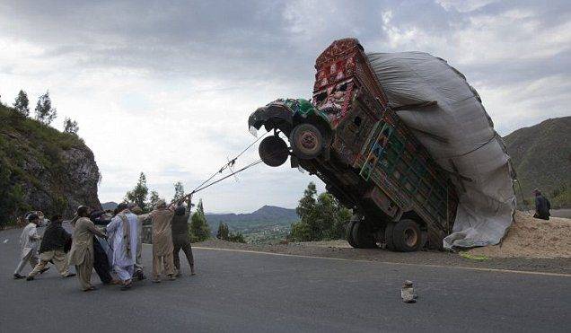

picture courtesy of http://metro.co.uk/2012/04/16/men-b...erloaded-with-wheat-straw-in-pakistan-390217/
The problem is that the CofG is too close to the back axle. The mass of equipment at the rear and the motor and cab at the front has a high inertia about the rear axle. Because the CofG is close to the rear axle most of the mass on either side of the axle cancels, so very little restoring force remains.
After lifting the front wheels, the vehicle CofG is accelerated by gravity downwards. The cab is effectively at the end of a long lever and so accelerates faster than the CofG. The driver will feel weightless.
There is a way to stop it jumping. Take your foot of the accelerator and brake momentarily as the front wheels hit and pass over the bump. That will load the front tyres sufficiently to remain in contact with the road. The converse is also probably true. If you rev up the engine, then drop the clutch, the front wheels will lift off the ground.
The vehicle is of dangerous design/modification because there is insufficient effective weight on the front wheels to guarantee steering control. It would be described as “light on” and would be expected to under-steer.
