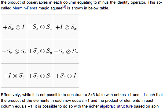

I'm trying to understand the strategy being put forward by the wikipedia article on quantum pseudo-telepathy to win the Mermin-Peres magic square game.
It's frustrating, because I do understand how pseudo-telepathy works, I just can't make heads or tails of the grid in the article:
3x3 grid of operator products for the Mermin-Peres magic square: row 1 +Sx⊗I, +Sx⊗Sx, +I⊗Sx; row 2 -Sx⊗Sz, +Sy⊗Sy, -Sz⊗Sx; row 3 +I⊗Sz, +Sz⊗Sz, +Sz⊗I.
I get that if I multiply the matrices in each cell across any row or column that I'll end up with +- identity matrix. I just don't know what that MEANS. I don't understand what the players are actually DOING that is represented by multiplying those matrices.
I look at it and all I see are questions:
- Where are the entangled qubits being fed into the system?
- If Alice gets row 1, is she computing InputSuperposition * (X tensor I) * (X tensor X) * (I tensor X) on it? What is she computing?
- How does she use the result to determine her moves?
- The X, Y, and Z Pauli matrices never mix their results, so how is this computation relying on quantum mechanics at all? It seems like I could do it all classically, which is clearly wrong because there's no classical winning strategy.
- Am I even right in assuming that the circle-with-X-inside is a tensor product, i.e. <1,2> tensor <3,4> = <3,6,4,8>?
Any help would be appreciated. I've asked in multiple places but mostly gotten silence in response.

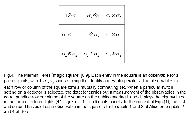

The paper that the table comes from is a bit more descriptive, but I still don't get it:
Mermin-Peres magic square: a 3x3 grid of two-qubit observables. Row 1: 1⊗σz, σz⊗1, σz⊗σz. Row 2: σx⊗1, 1⊗σx, σx⊗σx. Row 3: σx⊗σz, σz⊗σx, σy⊗σy.
I think the idea is to observe the outcomes of each entry in a row (or column). What I don't understand is how you observe Z tensor Z without preventing the system from allowing you to measure X tensor X. How does this all play out, in terms of the matrix multiplications?
I'm pretty sure this has something to with doing a partial measurement in an arbitrary basis, but the basis' that I see (e.g. the vectors in the matrix I tensor Z) are all of degree 4 meaning you get 2 bits of output and use up both qubits without being able to do the second or third measurements.

Looking at your questions again, I think I can actually say something. Bear in mind though, that my answers might be influenced by my lack of knowledge of the problem at hand.
I think so. They were certainly meant to be interpreted that way in the original Mermin paper (although he didn't consider it a game).
My guess is that she measures/computes what is the eigenvalue for the operator (X tensor I) in the InputSuperposition state for the first element, (X tensor X) for the second element of the row etc. This treatment seems to be consistent with "the paper that the table came from", specifically the second exercise. To be honest, if all they are doing is making measurements on an entangled state, I don't see why this is even considered a "game".
Well, it's straightforward to show that
[tex]\left[ \sigma_x^1 \sigma_x^2, \sigma_z^1 \sigma_z^2 \right] = 0[/tex]
so the two operators actually represent compatible observables. This should also mean that if the state was an eigenstate in the spin z-basis, it should also be an eigenstate of the X tensor X operation.
Do you mean how to do it in practice? Because I don't see any reason why we couldn't do something like
[tex]\hat{O}_1 |\psi \rangle = o_1 |\psi \rangle[/tex],
read off the eigenvalue and then keep it going through the next measurement
[tex]\hat{O}_2 o_1 |\psi\ \rangle = o_1 o_2 |\psi \rangle[/tex]
but I might be missing something.
I'll try.
Initially two maximally entangled pairs of qubits are prepared, a entangled with b and c with d. Alice takes a and c and Bob gets b and d. Later on Alice is told row number to fill. She only needs to do 2 measurements, the third is redundant, is is known what is it going to be. Let's say she's got row 1. She measures ##+S_x \otimes I## (which simply means measuring the first qubit along X axis and leaving the second qubit undisturbed) and puts in into cell ## M_{11}##. Then she measures measures qubit c along X axis, puts it into ## M_{13}## and finally sets ## M_{12}=M_{11} M_{13}##. Row 2 is a bit more tricky. Alice would have to measure for example ## -S_x \otimes S_z## and ## S_z \otimes S_x##. One way to do it would be to find a fancy unitary transformation on qubits a and c, such that ## -S_x \otimes S_z → Sz \otimes I ## and ## S_z \otimes S_x → I \otimes Sz ##.
The required transformation is ## U = \frac{1}{2} \left| \begin{array}{rrrr} 1 & 1 & 1 & -1 \\ 1 & -1 & 1 & 1 \\ 1 & 1 & -1 & 1 \\ -1 & 1 & 1 & 1 \end{array} \right| ## where the matrix is in the basis ##|a_+c_+\rangle##, ##|a_+c_-\rangle##, ##|a_-c_+\rangle##, ##|a_-c_-\rangle## (or something that looks roughy like that, I might have lost a minus sign somewhere along the way), which can be computed with some quantum gates:
Code:
a --H--*--H--X-- a'
c -----O-----X-- c'
Since quantum computations are reversible, measuring outputs a' and c' forces qubits a and c into one of the common eigenvectors of observables ## -S_x \otimes S_z## and ## S_z \otimes S_x## (and ## S_y \otimes S_y ## since they all commute).
Now, since Bob's qubits b and d were maximally entangled with a and c, they collapse into the same state as Alice's a and c, so when Bob measures one of these values he will get exactly the same result. Even if he does not measure the value in this row at all, two other measurements will come out just right that correct result for the cell can be inferred.

Perhaps this will clear things up.
A pair of photons (electrons) is prepared in the Bell state
|p⟩ = √½(|+⟩|+⟩ + |-⟩|-⟩) = (in computational basis) √½(|00⟩ + |11⟩) =
√½([1,0]⊗[1,0] + [0,1]⊗[0,1]) = √½[1,0,0,1].
One of the pair of photons is given to Alice, the other to Bob. If Alice makes a (Pauli) X or a Y or a Z measurement on her photon she will get + or - 1. If Bob selects the same measurement on his photon he will get the same value. A measurement by always yields +1.
Now another pair of photons is prepared in state |q⟩ in the same state as |p⟩, but independent of |p⟩. Again one of the pair goes to Alice the other to Bob.
Now in the game let's suppose Bob is told to select the middle column. Note that the operators X⊗X, Y⊗Y, and Z⊗Z have a common eigenvector basis of
√½[1,0,0,1] with eigenvalues +1 for X⊗X, -1 for Y⊗Y, and +1 for Z⊗Z
√½[1,0,0,-1] -1 +1 +1
√½[0,1,1,0] +1 +1 -1
√½[0,1,-1,0] -1 -1 -1
For specificity's sake let's further suppose that he measures his two photons 1st with Z⊗Z, i.e. he measures his photon from |p⟩ with the left Z and the one from |q⟩ with the right Z and he gets +1 for both. So +1 times +1 = +1 is the entry for Z⊗Z. The state thus becomes [1,0]⊗[1,0] = [1,0,0,0], which is an eigenvector of Z⊗Z with value +1. Writing this vector in the above eigenbasis gives [1,0,0,0] = ½[1,0,0,1] + ½[1,0,0,-1]. Now measuring this superposition with X⊗X gives either +1 resulting in the state √½[1,0,0,1] which when measured by Y⊗Y yields -1, or the measurement by X⊗X gives -1 resulting in the state √½[1,0,0,-1] which when measured by Y⊗Y yields +1. Hence in either case Bob gets only one -1, as required.
Now let's suppose that Alice was told to take the top row, she will get the same value for for X⊗X as did Bob and it's even easier to see she will get an even number of -1s.
BTW the wikipedia article statement that it is possible to appropriately fill the grid with "the richer algebraic structure based on spin" is false. All that this QM process does is appropriately fill the one row and one column that is requested of Alice and Bob.

I beg to differ. Measuring Z of p and Z of q separately is not the same as measuring Z⊗Z in one go. As you said, your recipe leaves the system in state [1,0,0,0]. On the other hand, measuring Z⊗Z once and getting +1 leaves the system in superposition of [1,0,0,0] and [0,0,0,1] which is not the same thing. Specifically,
## Z \otimes Z = \left| \begin{array}{rr}1&0\\0&-1 \end{array} \right| \otimes \left| \begin{array}{rr}1&0\\0&-1 \end{array} \right| = \left| \begin{array}{rrrr}1&0&0&0\\0&-1&0&0\\0&0&-1&0\\0&0&0&1 \end{array} \right| ##
has 2 eigenvalues +1 and -1 of multiplicity 2 each, with corresponding sets of eigenvectors (|00>, |11>) and (|01>, |10>). Measuring +1 projects the state onto subspace spanned by |00> and |11>.
One way of measuring Z⊗Z is to apply CNOT and then measure I⊗Z, which means measuring just the second qubit. Easy to see that Z⊗Z → CNOT† | Z⊗Z | CNOT = I⊗Z
To really get to the bottom of the Mermin square, one should consider all 4 qubits as a whole, which means working in 16-dimension space spanned by |0000>, |0001> ... |1111>
