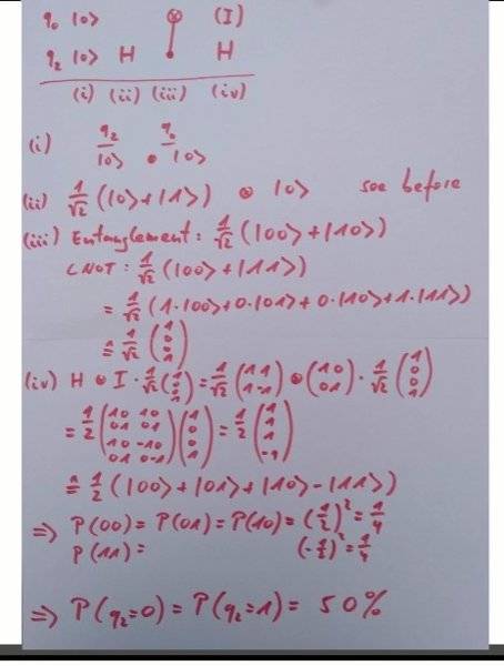

Now comes the tricky part!
By now, q0 and q1 are entangled. I want to measure q1, do a hadamart gate in q0 and measure q0, but I have no clue on how to do this math!
In the video, he did this: Hadamart tensor identity gate times the two qubit, like this:
## \begin{pmatrix} 0,7 & 0,7 \\ 0,7 & 0,7 \end{pmatrix} \otimes \begin{pmatrix} 1 & 0\\ 0 & 1\end{pmatrix} times \begin{pmatrix} 0,7 \\ 0 \\ 0 \\ 0,7 \end {pmatrix}##
I can't understand the logic behind "hadamart tensor identity times qubits", why he did it?
I attached the file showing how he did it, I'm lost at step 4.
Why he did a identity gate? Why he did it tensor a hadamart gate? How should I do the math if I wanted to do something different, like measure the q0 and do a x gate to q1?
Thanks again! =)

Hi @Joao . First, I have a nitpick: you should keep ##1/\sqrt{2}## instead of 0.7 (and not 0,7). Otherwise, the state will not be normalized to exactly 1.
Now, the reason for tensoring the gate is exactly the same reason that you tensor the two qubits. If you apply gates independently to the first and the second qubit,
$$ (A \otimes B) |a\rangle \otimes |b\rangle = (A|a\rangle) \otimes (B|b\rangle), $$ a special case of which is "doing nothing" to one of the qubit; that's doing the identity gate. The explicit form of a matrix tensor product is given by the Kronecker product.

Thanks a lot! It really helped me to understand it! Now I can do the math of a quantum eraser circuit all by myself! Now I'm going to try to do the math of a superdense coding circuit! Thanks a lot for helping me get a better understanding of the universe we live in! =)
