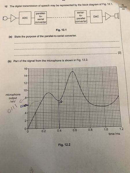

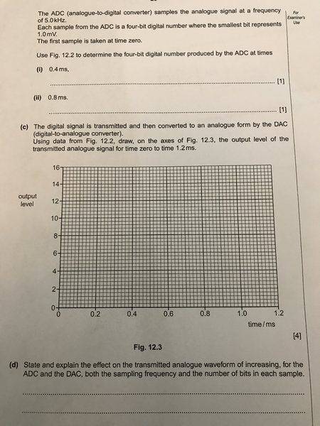

The digitial signal is transmitted and then converted to an analogue form by the DAC. Using data from Fig. 12.2, draw on the axes of Fig.12.3, the output level of the transmitted analogue signal for time zero to time 1.2 ms.
Four bit digital numbers being ised

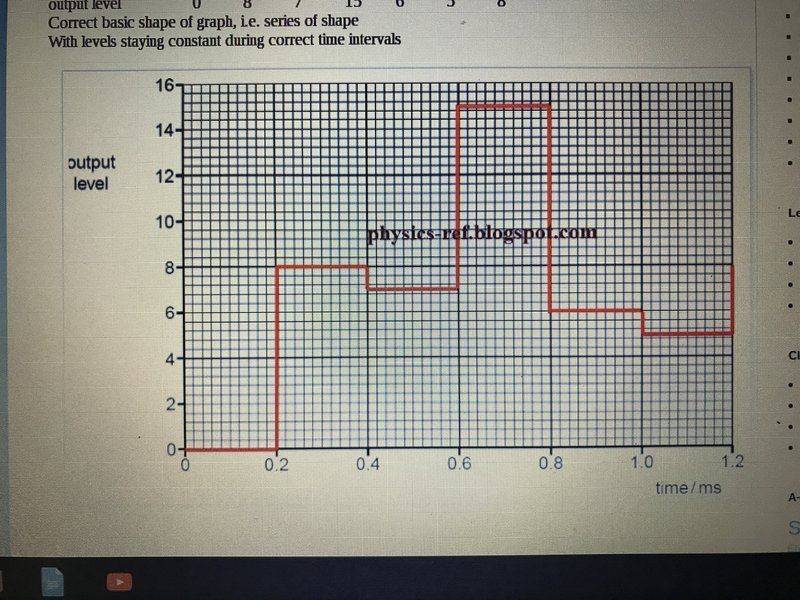

The solution of the graph is attached. I don't understand how they knew the graph will be constant between 0-0.2 and then 0.2-0.4. How did they calculate this? Secondly this graph looks like a digital graph more than an analogue graph?
I don't understand the conversion at all.

  • Exam diagram showing a digital speech transmission chain (ADC, parallel-to-serial converter, serial-to-parallel converter, DAC) and a graph of microphone output in mV against time in ms from 0 to 1.2 ms, with handwritten annotations 0111 and 0.4.
  • Blank graph grid for Fig. 12.3, with y-axis labelled output level from 0 to 16 and x-axis labelled time/ms from 0 to 1.2, to be plotted as a stepped DAC output.
  • Step graph of output level against time/ms from 0 to 1.2 ms, with output level 0 to 16 on the vertical axis; the red trace holds 0 to 0.2, 8 from 0.2 to 0.4, 7 to 0.6, 15 to 0.8, 6 to 1.0, 5 to 1.2.
What is the sampling frequency?

The output of the microphone is passed through an ADC.
It's 5kHz which I understand now so it's measuring it after every 2 ms which is why the intervals as such.
Yes and then it puts it back into a DAC.
And that DAC cannot recover any information that was lost in the A to D conversion.
