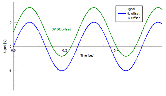

the DC voltage will produce an offset for the AC. This is called a DC Bias
That is, instead of the AC cycling above and below 0V , it will now cycle above and below whatever the DC value is
That is, instead of the AC cycling above and below 0V , it will now cycle above and below whatever the DC value isView attachment 206113Dave
