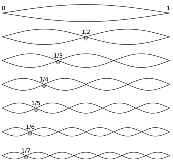

Am doing a project about a resonance chamber, investigating resonances frequenies and hows different variables can affect them but need some clarification on the modal numbers
so resonant frequencies are found from f=(c/2)[(Nx/Lx)^2(Ny/Ly)^2(Nz/Lz)^2]^1/2
find values using n = 1,0,0..,1,1,0 etc but what's do they actually mean? thanks
1,0,0 would refer to the values of Nx, Ny, and Nz.
Yes i know that, but what's their actual meaning?
Okay, now I understand what you're asking.
Each number refers to the number of half-wavelengths, or antinodes, that fit within the length (Lx, Ly, or Lz). Something like this:
Hope that helps.
