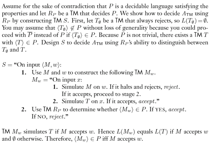

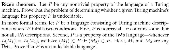

The Rice's theorem that I found in Sipser is the following:
and the proof is:
Why do we take the TM $T_{\varnothing}$ that always rejects?
Could you explain to me the first point at the description of the TM $S$? I am confused about how the TM $S$ works...
Which is the reduction from the Halting problem to P? Maybe $\langle M, w \rangle \mapsto M_w$ ?

I read the proof also at the link: CS 4810 but I don't understand why we distinguish these cases...
Yes. Unfortunately, reduction is introduced formally pretty late in Sipser, and there are several proofs of undecidability without explicit reference to reduction. In this case, it would be enough to describe how $M_w$ is built given $M$ and $w$ and to note that
\langle M,w\rangle\in A_{\text{TM}}\iff \langle M_w\rangle\in P.\qquad(*)
(To remind, in Sipser $A_{\text{TM}}=\{\langle M,w\rangle\mid M\text{ accepts }w\}$.) The current proof uses $R_P$ to prove a special case of the general theorem: if $L_1$ is reducible to $L_2$ and $L_1$ is undecidable, then so is $L_2$. If we have this general theorem, then constructing a reduction is enough.
The concrete $T_\emptyset$ is irrelevant. What is important is that all machines that accept the empty language are outside of $P$. (If this is not so, then the proof suggests proving that the complement of $P$ is undecidable.) Thus, if $M$ does not accept $w$, then $M_w$ does not accept anything either and so $\langle M_w\rangle\notin P$. This is the direction $(\Longleftarrow)$ of (*) above.
$S$ is used to decide $A_{\text{TM}}$ provided $R_P$ decides $P$. Again, it is not necessary if we have the theorem about reduction. $S$ constructs $M_w$ and runs $R_P$ on $\langle M_w\rangle$. If you need more information, please describe more precisely what you don't understand.

We assume that $\varnothing \notin P$ without loss of generality because if $\varnothing \in P$ we can proceed with $P^c$, which is also a non-trivial property of languages of TM.
Because $P$is not trivial, there exists a TM $T$ such that $L(T) \in P$.
We consider the computable function $f$ that maps $\langle M, w \rangle$ to $\langle M_w\rangle$, where $M_w$ is the following TM:
$$M_w(u) : \left\{\begin{matrix}
\text{ if } M(w) \downarrow \ \ \& \ \ M(w)=yes & \text{ then simulate } T(u). \\ \ \ \ \ & \text{ If } T(u)=yes \text{ then } M_w(u)=yes \\ \\
\text{ if } M(w) \downarrow \ \ \& \ \ M(w)=no &\text{ then } M_w(u)=no
\end{matrix}\right.$$
$M_w$ accepts on input $u$ iff $M$ accepts $w$ and $T$ accepts $u$.
Therefore, $L(M_w)=L(T)$ if $M$ accepts $w$ and $L(M_w)=\varnothing$ if $M$ does not accept $w$.
Since $L(T) \in P$ and $\varnothing \notin P$, we have that $L(M_w) \in P$ iff $M$ accepts $w$, i.e., $$\langle M_w\rangle \in L_P \Leftrightarrow \langle M, w \rangle \in L_H$$
So, $f$ is a reduction from $L_H$ to $L_P$. That means that $L_H \leq_m L_P$.
Is everything correct?
Could you clarify why it stands that $L(T_{\varnothing})=\varnothing$ ?
At the sentence "Therefore, $L(M_w)=L(T)$ if $M$ accepts $w$ and $L(M_w)=\varnothing$ if $M$ does not accept $w$. " we have that $L(M_w)=L(T)$ if $M$ accepts $w$ because on input $w$ both $M_w$ and $T$ accept? And we have that $L(M_w)=\varnothing$ if $M$ does not accept $w$ because $\varnothing=L(T_{\varnothing})$ and both $M_w$ and $T_{\varnothing}$ reject $w$?
mathmari said:
We will show that $L_H \leq_m L_P$
The reduction you are bullding is actually from $\{\langle M,w\rangle\mid M\text{ accepts }w\}$ and not from $\{\langle M,w\rangle\mid M\text{ halts on }w\}$. This is because you are showing
M\text{ accepts }w\iff \langle M_w\rangle \in L_P
and not
M\text{ halts on }w\iff \langle M_w\rangle \in L_P
However, modifying the construction to be a reduction from $L_H$ is easy.
mathmari said:
Because $P$ is not trivial, there exists a TM $T$ such that $L(T)\in P$.
In https://driven2services.com/staging/mh/index.php?posts/73374/ you defined $L_P$ as the language consisting of codes of those machines that satisfy $P$. However, in Sipser's proof in https://driven2services.com/staging/mh/index.php?posts/73400/ that language is denoted by $P$. In any case, I think that in the latest posts $P$ did not denote a property of languages, so you can't write $L(T)\in P$. It's best to summarize notation before a complete proof.
mathmari said:
$$M_w : \left\{\begin{matrix}
The thing on the left of the big curly brace should be $M_w(u)$ and not $M_w$.
By definition of $T_\emptyset$ and $L(\cdot)$.
Not at all. $L(M_w)=L(T)$ means that $M_w$ and $T$ accept (i.e., say "yes") on the same set of words, and not only $w$.
Again, $L(M_w)=\emptyset$ means that $M_w$ does not accept any word, not just $w$.
The theorem is
Let $P$ be any non-trivial property of languages of Turing machines. Then, the following language is undecidable
$L_P=\{\langle M \rangle \mid L(M) \text{ satisfies } $P$ \}$
I made some changes at the proof:
Let $L_H$ be the language of the Halting problem.
We will show that $L_H \leq_m L_P$. Since $L_H$ is undecidable, $L_P$ will also be undecidable.
Let $T_{\varnothing}$ be a TM that always rejects, so $L(T_{\varnothing})=\varnothing$.
We assume that $\varnothing$ doesn't satisfy $P$ without loss of generality because if it would satisfy we can proceed with $P^c$, which is also a non-trivial property of languages of TM.
Because $P$ is not trivial, there exists a TM $T$ such that $L(T)$ satisfies $P$.
\text{ if } M(w) \downarrow & \text{ then simulate } T(u). \\ \ \ \ \ & \text{ If } T(u)=yes \text{ then } M_w(u)=yes \\ \\
\text{ if } M(w) \uparrow &\text{ then } M_w(u) \uparrow
$M_w$ accepts on input $u$ iff $M$ halts and $T$ accepts $u$.
Therefore, $L(M_w)=L(T)$ if $M$ halts and $L(M_w)=\varnothing$ if $M$ does not halt.
Since $L(T)$ satisfies $P$ and $\varnothing$ doesn't satisfy $P$, we have that $L(M_w)$ satisfy $P$ iff $M$ halts, i.e., $$\langle M_w\rangle \in L_P \Leftrightarrow \langle M, w \rangle \in L_H$$
