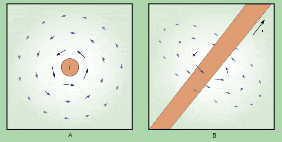

A paradox?...In STR.
A thought experiment;
This could take place in a hallway or in space, whichever you prefer.
Consider an electron somewhere around the center of your monitor. Now have an observer A at the right of your screen closing the distance between the electron and himself in a uniform manner. The STR allows this observer to claim to be at rest and that the electron is moving toward him and emitting a rotating magnetic field in the correct manner if he could see it.
At the same time have observer B coming from the left of your monitor closing the distance between the electron and himself. Observer B is moving in a uniform manner. Observer B can also claim to be at rest and that the electron is moving toward him emitting a rotating magnetic field in the correct manner. The electron would have to emit two fields rotating in opposite directions to satisfy each observer.
Because the electron has a rotating magnetic field, does it have to be placed in a preferred reference frame?
How does the electron know which way it is moving in order to emit the proper field.
Does the electron have to be accelerating in order to produce a rotating magnetic field?
I sent this "paradox' to two physicists. They didn't reply so something must be wrong with the way I phrased it. It was unsolicited so was probably trashed. Any ideas?

Let's back up a bit. Where exactly does SR come into this?
Let's pretend the universe is Newtonian for a moment. We have two frames where the electron direction is different. In these same two frames the magnetic field direction is also different. Why is the second statement more problematic than the first? Why is the first statement problematic? And how does SR allegedly chage things?
Lasand said:
It's the rotation of the field, and it's direction of rotation to different observers that puzzles me. I seem to end up having to give the electron absolute motion.
Have you actually worked this out numerically? You should wind up with the same force on the test charge regardless of the field direction. If not, please post your work and we will be glad to help.

I'm still a bit confused also. It is understood that a moving charge has a magnetic field rotating around it. That accounts for the magnetic field around a current carrying conductor. There can be not doubt about this, that the field around a wire is an ensemle of moving charges that can deflect a compass needle. I still speculate about an alternative.
Are you referring to the normal magnetic field produced by constant current flow? The magnetic field "lines" go around the conductor, but the field is static. In those little pictures with an arrow on the circular magnetic field lines, the arrows indicate the polarity of the magnetic field, not rotation. There is no mass there to "rotate".
If the current is constant, the magnetic field will not move around at all, it will remain "stationary". If the current is varying, the magnetic field may get bigger or smaller, or change polarity (direction). Nothing "rotates".

What's the problem with it having two directions? This happens in Newtonian physics all the time.
Both observers see the electron moving towards them.
Both see an electric current consistent with the electron's motion as they observe it.
Both see a magnetic field consistent with the current as they observe it.
Where is the problem? (And again, the above statements are true even without relativity)
BTW, I also agree that you shouldn't use "rotating magnetic field" to describe the field - that implies a time-varying field, and this field is static. See JesseM's pictures.
