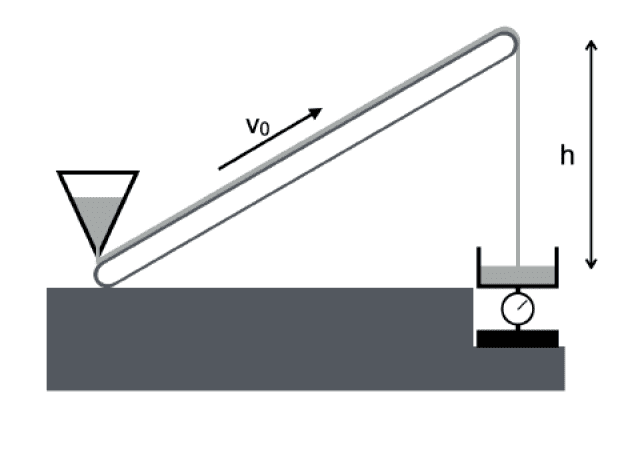

Upon a sloping roller and from a negligible height, sand is placed with a rhythm of dmdt. Thanks to an engine that provides a power W, the speed of the roller is kept constant (v0). The roller brings the sand up to a certain amount height, from which it then falls vertically with the initial velocity of magnitude v0 on a container placed at the base level of the roller, h lower. The container is placed upon a scale (see drawing). At a certain instant t, when the roller is already covered with sand and a mass M of sand has accumulated in the container, Determine:
1) the power provided by the engine W;
2) the momentum transferred to the sand by the scale in the unit of time dp/dt;
3) the weight indicated by the scale.

Consider a small period of time dt.
What mass of sand is added at the bottom in that time? How much energy (KE+PE) does it bring with it?
What mass of sand leaves at the top in that time? How much energy (KE+PE) does it take away with it?
1) dm, 0
2) dm, ##\frac{1}{2}(dm)v_0^2 + (dm)gh##

The belt knows nothing about what happens to the sand after it leaves. Concentrate on the work done to get the sand from stationary at the bottom to moving at the top.
You have already found the work done in time dt. Deducing the power is trivial.

Why don't you think that the work done in time dt is $$dW=\frac{dm}{2}v_0^2+dmgh$$ cause that's includes not only the change in the potential energy ##dmgh## of the mass dm but also the change in kinetic energy $$\frac{1}{2}dmv_0^2$$.

Each dm arrives on the belt with zero PE and zero KE. It leaves with the PE and KE you found in post #5. How much energy does it gain? Where did that energy come from?

So we can calculate power:
##\frac{dm}{dt} = \lambda ##
## P = \frac{dW}{dt}## = ## \frac{1}{2}\lambda v_0^2 + \lambda gh##
As for the second and third question, I did it this way:
2)
##q_i = dmv_0##
##q_f = dm\sqrt{2gh + v_0^2}## (velocity calculated by conservation of energy)
##\frac{dq}{dt} = \lambda(\sqrt{2gh + v_0^2} - v_0^2)##
3) Weight registered by the scale = Mg + the weight of the sand that is flying
Where the weight of the sand that is flying is equal to:
##\lambda(\sqrt{2gh + v_0^2} - v)## where ## \frac{(\sqrt{2gh + v_0^2} - v)}{g} ## is the fall time

I think you are correct here.

I think you should NOT include the term ##-\lambda v_0^2## in the above expression, because the momentum of the sand just before it hits the container is ##dm\sqrt{2gh+v_0^2}## and after it hits the container is zero.

I think (not very condifent myself here though ) that the correct answer here should be $$Mg+\frac{dp}{dt}$$

It's steady state. The total on the belt is not changing.

Ok i understood your correction on question 2, but why is that the correct answer on question 3?
Is it because ##\vec{F_{ext}} = \frac{d\vec{p}}{dt}## ?

Yes. The scale 'knows' nothing about the past history of the sand. It is only affected by the fact that sand is arriving at a certain mass rate and a certain velocity.
