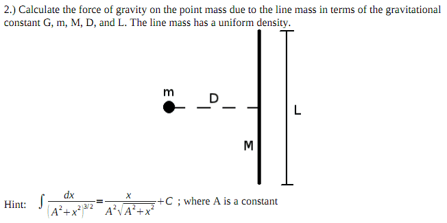

Calculate the force of gravity on the point mass due to the line mass in terms of the gravitational constant G, m, M, D, and L. The line mass has a uniform density.
Ok so apparently I'm suppose to consider the point at were the point mass is to be the origin of the Cartesian coordinate system. To the right of this point is positive. Up from this point is positive. Below this point is negative. If the dotted line is extended through the line mass than the y components of the gravity contributed by the infinitismal masses were cancel each other out directly.

  • Diagram of a point mass m located a distance D to the left of a vertical line mass M of length L, with the gap D shown as a dashed line between them.
