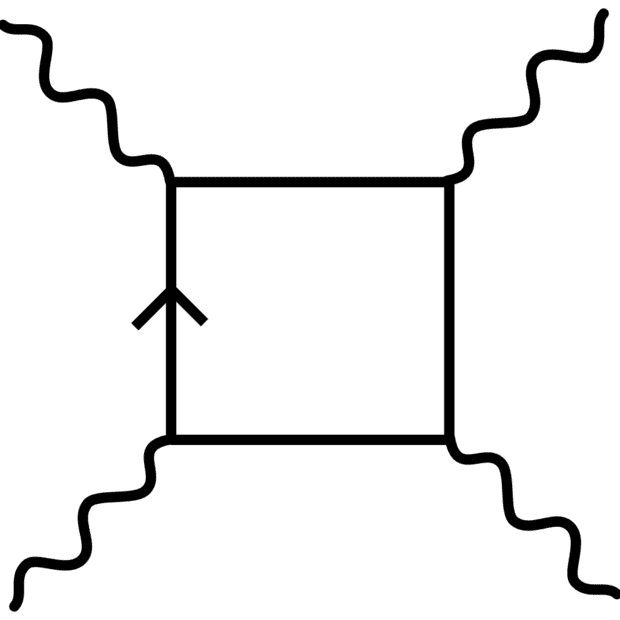

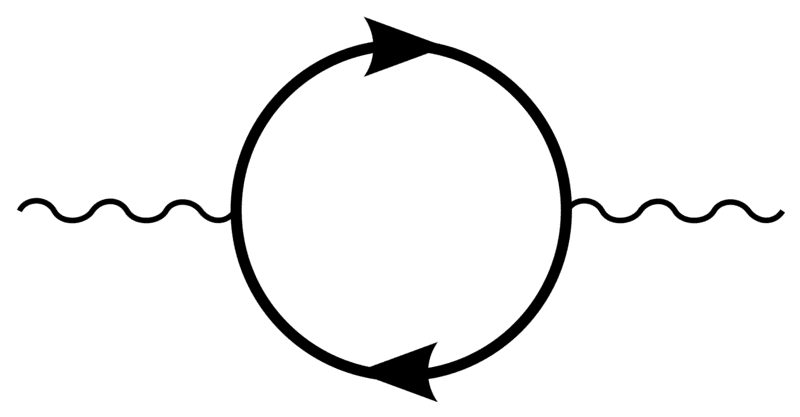

What determines the order of the vacuumpolarisation? I've added 2 Feynman Diagrams for refference. The first one shows the vacuumpolarisation of the lowest order the second shows the vacuumpolarisation of the 2nd order. What is the difference?

Well, it's not. It's light-by-light scattering.

Yeah, but on Wikipedia the second pic is described by the words: Vacuumpolarisation second order

Nah, I am just madly confused haha. It is indeed Light by Light scattering, but why does it have that name given to it? Or how would a vacuumpolarisation second order look like?

What's called "vacuum polarization" is usually referring to the photon self-energy diagrams, i.e., Feynman diagrams with two external wiggly photon lines. So the one-loop 1st diagram is a vacuum-polarization diagram, the 2nd diagram has four external photon lines, and it describes the elastic scattering of photons. This is a process that's not included in classical electrodynamics, i.e., it is purely due to the radiative corrections of the quantized theory, QED. You can get a contribution to the vacuum polarization by connecting two of the external lines to an internal photon line. Another example is if you take the 1st one-loop diagram and draw a photon line connecting the two internal electron-positron lines. These are then two-loop contributions to the vacuum polarization of the photon.

But a terrible example of one, as it has no measurable effects. Photon goes in, photon with the same kinematics comes out.
Of course self-energy insertions to external legs have no observable consequences. That's the point of renormalization after all!
